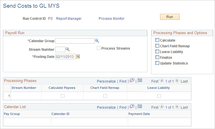

Use the Send Costs to GL MYS page (GPMY_GL_PREPARE) to initiate the processes for calculation of general ledger data, leave liability, ChartField remapping, finalization of the GLI, and statistical data updates.

This example illustrates the fields and controls on the Send Costs to GL MYS page. You can find definitions for the fields and controls later on this page.

ChartField Remap |
Select this option to enable the ChartField Remapping process (GPMYS_GL_MAP) when running the General Ledger process. The ChartField Remapping process updates ChartFields in GP_GL_DATA. The GLI finalize process summarizes the data by using the remapped Chartfields. |
Note: This page provides the additional processing phase options Leave Liability and ChartField Remap. These options are not available on the page that you access when you select
