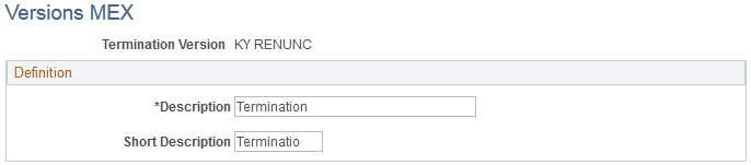

Use the Versions MEX page (GPMX_TERM_VERSION) to define termination versions.
Navigation:
This example illustrates the fields and controls on the Versions MEX page. You can find definitions for the fields and controls later on this page.
Field or Control |
Description |
Termination Version |
Name and describe the termination version. This version name enables you to group all of the qualifying actions and reasons for making a set of termination payments. |

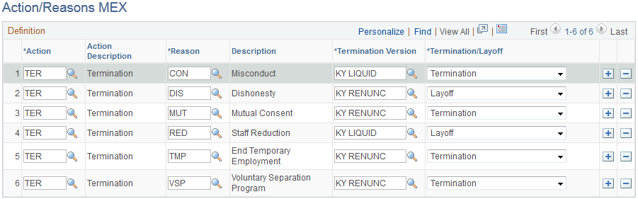

Use the Action/Reasons MEX page (GPMX_TERM_ACTN_RSN) to define qualifying actions and reasons for triggering termination pay.
Navigation:
This example illustrates the fields and controls on the Action/Reasons MEX page. You can find definitions for the fields and controls later on this page.
Field or Control |
Description |
Action andAction Description |
Specify the action corresponding to a termination version that triggers termination pay in combination with a specific reason. The system displays the description of the selected action. |
Reason andDescription |
Specify the reason corresponding to a termination version that triggers termination pay in combination with the specified action. The system displays the description of the selected reason. |
Indicate the termination version for the action and reason combination that you specified trigger termination pay. Note: Termination versions are assigned at the action and reason level. When a payee is terminated, a service operation inserts the version as a supporting element override at the payee level. This is explained in detail in another topic. |
Termination/Layoff |
Specify whether the reason for the payee's departure is Layoff or Termination. Note: This information is inserted as a supporting element override (variable) at the payee level and is used in formulas that trigger and process termination payments. For example, the seniority premium is always paid for layoffs, but it is paid for a termination only if the payee has 15 or more years of seniority. |
