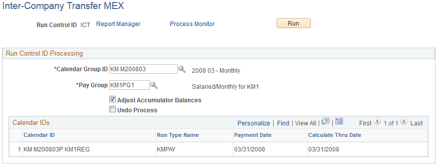

Use the Inter-Company Transfer MEX page (GPMX_RC_INTERCOM) to run the Inter-Company Transfer process to adjust accumulator balances for employees having transfer between internal companies.
Navigation:
This example illustrates the fields and controls on the Inter-Company Transfer MEX page. You can find definitions for the fields and controls later on this page.
Run Control ID Processing
Field or Control |
Description |
Calendar Group ID |
Select the calendar group for which you want to process data for employees with inter-company transfers. |
Pay Group |
Select the pay group for which you want to process data for employees with inter-company transfers. |
Adjust Accumulator Balances |
Select this check box to have the Inter-Company Transfer process adjust accumulator balances when processing employees with inter-company transfers. The process sets the accumulators values of the old company to zero and moves these accumulator values to the prior employer data record according to the values set on the Inter-Company Parameters MEX page. |
Undo Process |
Select this check box to have the Inter-Company Transfer process reverse the changes that it made to accumulator values for employees with inter-company transfers. The process readjusts the accumulators to their original value and removes the prior employer data from the Define Prior Employer Data MEX page. |
Calendar IDs
The system displays the calendars and their associated run type, payment date, and calculate thru date.
