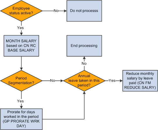

Monthly Salary
Global Payroll for China delivers the MONTH SALARY earning as an example of how to calculate monthly salary for your payees.
The CN GC ACTIVE generation control ensures that only payees with a Job status of Active receive the MONTH SALARY earning.
The system determines the amount of MONTH SALARY based on the CN RC BASE SALARY rate code.
The post processing formula CN FM REDUCE SALRY reduces MONTH SALARY by any leave taken during the period.
The proration rule GP PRORATE WRK DAY prorates MONTH SALARY based on the number of days worked in the calendar period.
Note: Proration and rounding rules are set at the pay group level.
This diagram illustrates the process flow for the MONTH SALARY earning:
This diagram illustrates the process flow for the MONTH SALARY earning.

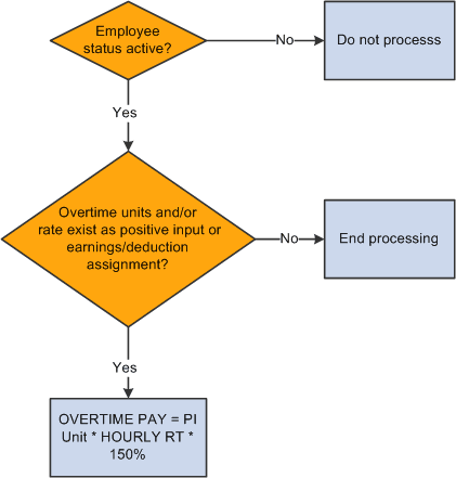

Overtime Pay
Global Payroll for China delivers the OVERTIME PAY earning as an example of how to calculate overtime pay for your payees.
The system calculates OVERTIME PAY using positive input units * HOURLY RT * 150%.
No proration is required because the assumption is that OVERTIME PAY will be entered through positive input.
This diagram illustrates the process flow for the OVERTIME PAY earning:
This diagram illustrates the process flow for the OVERTIME PAY earning.

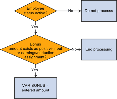

Variable Bonus
Global Payroll for China delivers the VAR BONUS earning as an example of how to enter variable bonus pay for your payees.
VAR BONUS is a fixed amount earning entered through positive input.
No proration is associated with VAR BONUS.
This diagram illustrates the process flow for the VAR BONUS earning:
This diagram illustrates the process flow for the VAR BONUS earning.

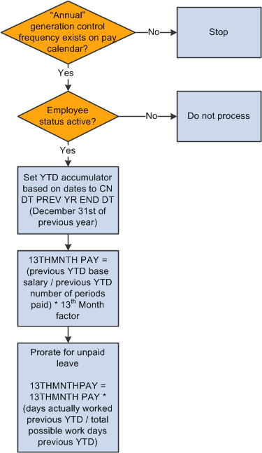

13th Month Pay
Global Payroll for China delivers the 13THMNTH PAY earning as an example of how to provide 13th Month Pay for your payees.
The system pays 13THMNTH PAY annually based on the previous 12 months' earnings.
The system calculates 13THMNTH PAY using a payee's base monthly salary only (annual salary/12, prorated for days worked during the month), not the actual MONTH SALARY earning. It also does not include any allowances or deductions in the calculation of 13THMNTH PAY.
For payees hired between the 1st and 15th of a month in the calculation year, 100% of their base monthly salary for the hire month and subsequent months contributes to 13THMNTH PAY. For payees hired after the 15th of a month, 50% of the base monthly salary for the hire month and 100% of the base monthly salary for subsequent months contribute to 13THMNTH PAY.
The system prorates 13THMNTH PAY for unpaid vacation leave taken during the year, that is, leave days exceeding the annual leave entitlement.
This diagram illustrates the process flow for the 13THMNTH PAY earning:
This diagram illustrates the process flow for the 13THMNTH PAY earning.

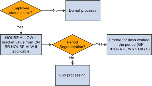

House Allowance
Global Payroll for China delivers the HOUSE ALLOW earning as an example of how to calculate a house allowance for your payees.
The system calculates the HOUSE ALLOW earning based on the CN BR HOUSE ALW bracket, which associates house allowances with annual rates of pay.
The system prorates HOUSE ALLOW for calendar periods using GP PRORATE WRK DAY.
This diagram illustrates the process flow for the HOUSE ALLOW earning:
This diagram illustrates the process flow for the HOUSE ALLOW earning.

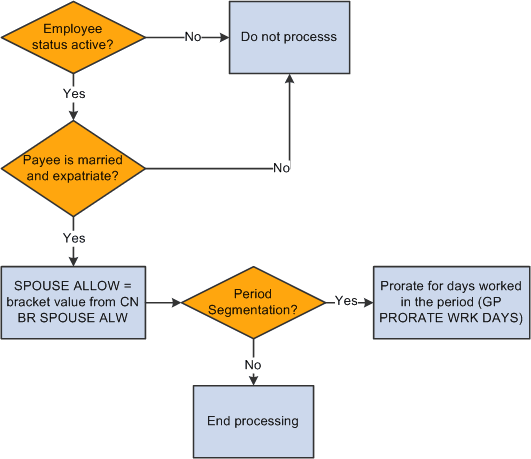

Spouse Allowance
Global Payroll for China delivers the SPOUSE ALLOW earning as an example of how to calculate a spouse allowance for your payees.
The generation control CN GC SPOUSE CHK determines whether payees are eligible for the SPOUSE ALLOW earning based on their marital status and employee type. Only married expatriate payees receive the SPOUSE ALLOW earning.
The system calculates the SPOUSE ALLOW earning based on the CN BR SPOUSE ALW bracket, which associates spouse allowances with employee type and annual rate of pay.
The system prorates SPOUSE ALLOW for calendar periods using GP PRORATE WRK DAY.
This diagram illustrates the process flow for the SPOUSE ALLOW earning:
This diagram illustrates the process flow for the SPOUSE ALLOW earning.

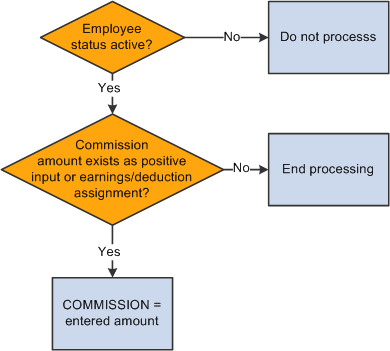

Commission
Global Payroll for China delivers the COMMISSION earning as an example of how to enter commission pay for your payees.
COMMISSION is a fixed amount earning entered through positive input.
No proration is associated with COMMISSION.
This diagram illustrates the process flow for the COMMISSION earning:
This diagram illustrates the process flow for the COMMISSION earning.
