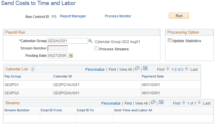

Use the Send Costs to Time and Labor page (GP_TL_PREPARE) to update the payable status of payable time entries in Time and Labor; return cost data if Labor Distribution is enabled.
Before using this page, you must finalize the pay run.
Navigation:
This example illustrates the fields and controls on the Send Costs to Time and Labor page.
You can run the update process only once per pay run. If you used process streams to run the payroll, you can use the same process streams to send data back to Time and Labor. You start the run control for one stream at a time, returning to this page after each launch to invoke the next stream.
Payroll Run
Field or Control |
Description |
Calendar Group |
Select the calendar group for sending data to Time and Labor. You can select finalized calendar groups only. |
Stream Number and Process Streams |
If the selected calendar group is defined for stream processing, the Process Streams check box is selected. Enter the stream number to process. |
Posting Date |
Displays the current date as the default value that the user can change to the desired posting date. If GL has been run, the field is not available for entry and it displays the GL posting date. |
Processing Options
Field or Control |
Description |
Update Statistics |
This check box is for the database administrator to help with fine-tuning system performance. If selected, the system generates statistics during batch processing that provide information about how worktables are being used. |
Calendars List
Field or Control |
Description |
Pay Group and Calendar ID |
The Pay Group field displays the pay group that is associated with the calendar that appears in the Calendar ID field (associated with the Calendar Group ID field). |
Payment Date |
Displays the calendar's payment date. |
Streams
Field or Control |
Description |
Stream |
Displays the number of the stream that has been processed. |
EmplID From and EmplID To |
Displays the employees who were processed for this stream. |
Sent Time and Labor At |
Displays the time that the process stream was sent to Time and Labor. |
