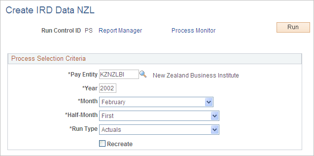

Use the Create IRD Data NZL page (GPNZ_IRD_RC_CR8) to set the parameters to control the date output from the AE process.
Navigation:
This example illustrates the fields and controls on the Create IRD Data NZL page. You can find definitions for the fields and controls later on this page.
Field or Control |
Description |
Half-Month |
Select First or Second. The selection that you make here interacts with your selections in the Run Type field and the Recreate check box. |
Run Type |
Accept the default Actual or select Exceptions. You can only select Exceptions if the half-month is two. When you select Exceptions, the process checks that the status of the IR 348 in the data table for the pay entity, year, and month is IR 348 Issued. |
Recreate |
If you select this check box for an actuals run, the process checks:
If you do not select this check box, the process checks:
Note: The Recreate check box has no effect on an exception run, so you should not select it.
