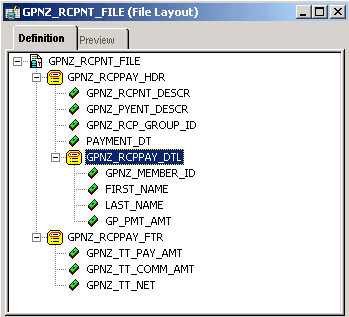

The process creates a separate flat file for each recipient/group ID/Pay Entity/Pay Date combination. The files are named xxxxxx99. TXT where xxxxxx is the recipient ID and 99 is a sequence number.
We have supplied a sample file layout, GPNZ_RCPNT_FILE. Application Engine program GPNZ_RCPFILE gets the file layout which is stored on the Deduction Recipients NZL page.
Note: The Application Engine program GPNZ_RCPFILE is written to process only the GPNZ_RCPNT_FILE recipient schedule file. You can make minor changes to that file, for example field order, but if you make major file layout changes you will need to create additional Application Engine programs to process them.
This example illustrates a sample recipient file layout.

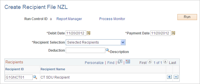

Use the Create Recipient File NZL page (GPNZ_RUNCTL_RCP_FL) to enter the parameters for generating recipient payment files.
Navigation:
This example illustrates the fields and controls on the Create Recipient File NZL page. You can find definitions for the fields and controls later on this page.
Field or Control |
Description |
Debit Date |
The system extracts recipient payments where the debit date is equal to the recipient's deposit schedule. If the recipient does not have a deposit schedule the system exacts payments using the debit date without reference to a deposit schedule. |
Payment Date |
This is the date, passed to the file header, that the bank passed the payment to the recipient. It is written to the output report file. |
Recipient Selection |
Select from All Recipients, Selected Deduction, or Selected Recipients. You select only one deduction but multiple recipients for the second and third options. |
Note: The recipient file report GPNZPY52 is an SQR version of the data extracted for the electronic recipient file. When you select to run the Create Recipient Schedule File Application Engine process in the PeopleSoft Process Scheduler Request page, you automatically get the SQR. You can then reprint the SQR later without rerunning the AE by selecting the check box and leaving the AE check box blank.
