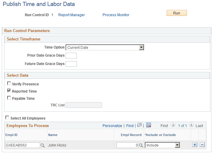

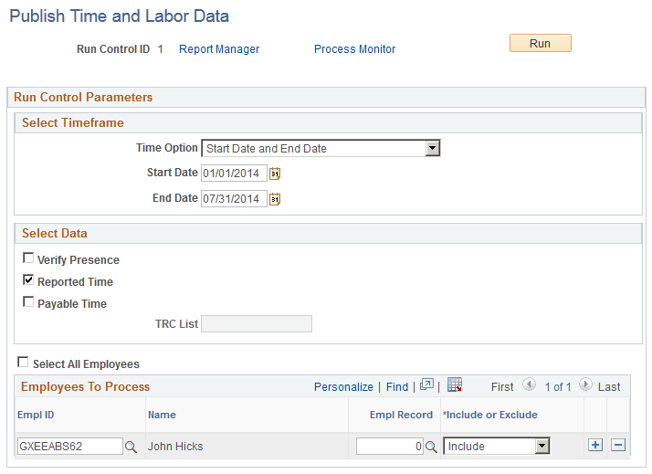

Use the Publish Time and Labor Data page (TL_TIME_DATA) to send reported punch and approved time to Clairvia.
Run the TL_PUB_TLDAT process.
Navigation:
This example illustrates the fields and controls on the Publish Time and Labor Data page (showing Current Date time option). You can find definitions for the fields and controls later on this page.
This example illustrates the fields and controls on the Publish Time and Labor Data page (showing Start Date and End Date time option). You can find definitions for the fields and controls later on this page.
Field or Control |
Description |
Time Option |
Select the time frame for the published data. The values are: Current Date and Start Date and End Date. Select Current Date to use the system date as the reporting period to collect the data for publishing. Select Start Date and End Date to specify a reporting period. |
Start Date and End Date |
Enter the range of dates to process. These fields are available if you select Start Date and End Date in the Time Option field. |
Prior Date Grace Days |
Enter the number of days before the current date you want to include in the data published to Clairvia. The system uses a reporting period start date equal to the system date minus the value in this field. This field is only available if you select Current Date in the Time Option field. |
Future Date Grace Days |
Enter the number of days in the future you want to include in the data published to Clairvia. The system uses a reporting period end date equal to the system date plus the value in this field. This field is only available if you select Current Date in the Time Option field. |
Verify Presence |
Select to publish the punch time for all employees, or any employees specified in the Employees to Process grid. For employees that have punch time when the process initiates, the system publishes the punch time so that Clairvia can track employees that are present at work. The system publishes any punch times that are available at publishing time, with a status of SV- Saved, NA - Needs Approval, AP – Approved, and SB – Submitted. Leave data is not included when you select this option. |
Reported Time |
Select to publish reported punch time, reported leave, and leave balances to Clairvia. Only reported time with a status of SB-Submitted, or AP-Approved, is published. |
Payable Time |
Select to publish employee payable time to Clairvia. The system publishes payable time with any status other than DN, CL, IG, OE, NP, PB, and RV. In addition, payable time with a negative quantity that is not offset, is published to Clairvia. If you specify a TRC List, the system only publishes payable time with those TRC’s in the TRC List to Clairvia. Note: Payable Offsets are not published to Clairvia. The system identifies offset rows where the ORIG_SEQ_NBR is not zero. |
TRC List |
Select which TRCs the system uses when publishing payable time within the reported period to Clairvia. Leave this field empty to publish all payable time within the reported period. This field is only available when you select the Payable Time option. |
Select All Employees |
Select to publish the leave balance for all enrolled employees for the selected date range. Deselect this field to specify employees to include or exclude from processing. |

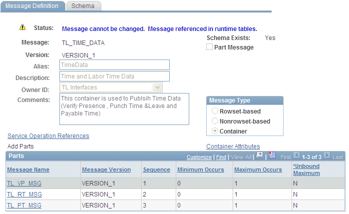

Message Definition
When you run the TL_PUB_TLDAT process from the Publish Time and Labor Data page, the system publishes the TL_TIME_DATA Integration Broker message to Clairvia.
This example illustrates the fields and controls on the Message Definition page, showing the parts of the TL_TIME_DATA message. You can find definitions for the fields and controls later on this page.
The TL_TIME_DATA message is a container with 3 parts:
TL_VP_MSG contains punch time data only. This is the information specified by the Verify Presence option on the Publish Time and Labor Data page.
TL_RT_MSG contains reported time data including all punch time, reported leave, and leave balances. This is the information specified by the Reported Time option on the Publish Time and Labor Data page.
TL_PT_MSG contains the payable time data. This is the information specified by the Payable Time option on the Publish Time and Labor Data page.

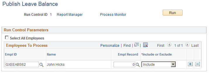

Use the Publish Leave Balances page (TL_TIME_DATA) to send the Base Benefits leave balances for subscribed employees to Clairvia.
Navigation:
After integrating Time and Labor and Clairvia for the first time, send all of the leave balances for the subscribed employees to Clairvia using the Publish Leave Balances process (TL_PUB_LVBL.)
This example illustrates the fields and controls on the Publish Leave Balances page. You can find definitions for the fields and controls later on this page.
Field or Control |
Description |
Select to publish the leave balance, as of the current date, for all enrolled employees. Deselecting this field enables you to specify employees to include or exclude from processing. |

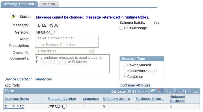

Message Definition
When you run the TL_PUB_LVBL process from the Publish Leave Balance page, the system publishes the TL_LB_MSGC Integration Broker message to Clairvia.
This example illustrates the fields and controls on the Message Definition page, showing the parts of the TL_LB_MSGC message. You can find definitions for the fields and controls later on this page.
The TL_LB_MSGC message is a container with one part. The message, TL_LB_MSG, contains data from the TL_OWSSR_RUNCTL, TL_RUN_CTRL_GRP, TL_COMPLEAV_TBL, and JOB tables.

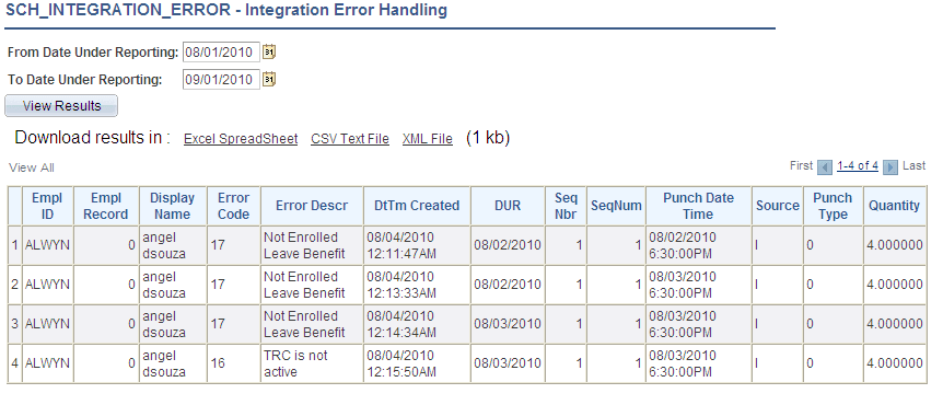

Time and Labor uses the SCH_OWS_INTEGRATION App Class and the SCH_OWSVALID Application Engine to handle inbound messages from Clairvia.
Clairvia publishes finalized schedules and leave to Time and Labor using the SCH_OWS_SCHEDULE message. The system performs the following steps after receiving the message:
Time and Labor validates the schedule punch time and leave time. The system performs basic leave validations including validating the reporting code and the employee’s leave balance.
The system inserts valid schedules into the PS_SCH_ADHOC_DTL table, and inserts a summary of schedules into the PS_SCH_MNG_SCH_TBL table.
Valid leave is inserted into the PS_TL_RPTD_TIME table with a REPORTED_STATUS of AP. The leave plan balance is updated in the TL_COMPLEAV_TBL table.
Invalid schedule and leave data is inserted into the SCH_INTEG_ERROR table.
The system sends a response message (SCH_OWS_MESSAGE) to Clairvia.
When all rows are processed successfully, the system sends a success response message to Clairvia.
Information in error is returned to Clairvia for correction. The message includes the employee’s information a rejection reason code. You can review the error data with the SCH_INTEGRATION_ERROR query.
Rejection Reason Codes
The following table lists the rejection reason codes:
Error Code |
Description |
1 |
Invalid Employee and Employee Record Number |
2 |
Invalid Schedule Source |
3 |
Invalid Schedule Category |
4 |
Invalid Punch Type |
5 |
Invalid Activity |
6 |
Invalid Activity Type |
7 |
Invalid Event |
8 |
Invalid Time Zone |

The following graphic shows an example of the results of the SCH_INTEGRATION_ERROR query in the Query Viewer:
This example illustrates the fields and controls on the SCH_INTEGRATION_ERROR query results in the Query Viewer.
