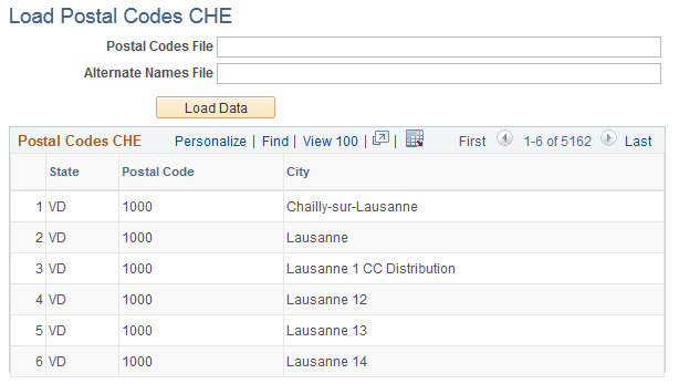

Use the Load Postal Codes CHE page (POSTAL_LOAD_CHE) to load Swiss postal code information into the Valid Addresses table.
Navigation:
This example illustrates the fields and controls on the Load Postal Codes CHE page. You can find definitions for the fields and controls later on this page.
Field or Control |
Description |
Postal Codes File |
Enter the complete path to the Postal Code file that you downloaded from the Swiss Post. |
Alternate Names file |
Enter the complete path to the Alternate Names file that you downloaded from the Swiss Post. |
Load Data |
Click to load the postal code data into the Valid Addresses table. |
State, Postal Code, and City |
Initially, these fields display the current data from the Valid Addresses table. After you run the load process, the updated information appears. |
