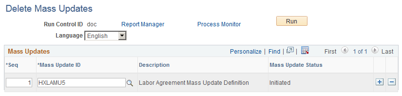

Use the Delete Mass Updates page (RUNCTL_MU) to delete mass update transactions that you have generated and which are pending processing.
Navigation:
This example illustrates the fields and controls on the Delete Mass Updates page. You can find definitions for the fields and controls later on this page.
The Mass Update Manager triggers the Mass Update Delete Application Engine (AE) process (HR_MASS_DEL) to perform the transaction deletion. The Mass Update Delete process deletes the pending mass update transactions that you have generated through the Create Mass Updates component for the selected mass update definitions. The process also performs the necessary cleanup of the system tables.

Use this group box to specify the mass update definitions for which you want to delete mass update transactions.
Field or Control |
Description |
Seq(sequence) |
Specify the order in which you want the process to delete mass update transactions. By default, the system sets the first row to 1 and automatically increments by 1 each additional row. |
Mass Update ID and Description |
Select the mass update definition that contains the mass update transactions that you want to delete. The system displays the name of the mass update definition. You can select only from mass update definitions that are initiated or in progress. |
Mass Update Status |
The system displays the status of the mass update definition. |
