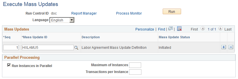

Use the Execute Mass Updates page (RUNCTL_MU) to run the Mass Update process.

This example illustrates the fields and controls on the Execute Mass Updates page. You can find definitions for the fields and controls later on this page.
Mass Updates
Use this group box to select the mass update definitions for which you want to process the mass update transactions.
Field or Control |
Description |
Seq (sequence) |
Indicates the order in which the process performs the mass update. By default, the system sets the first row to 1 and automatically increments by 1 for each additional row. |
Mass Update ID and Description |
Select the mass update definitions that you want to include in the processing. You can select only from the mass update definitions that are initiated or in progress. The system displays the description of the selected mass update definition. |
Mass Update Status |
The system displays the status of the mass update definition. |
Parallel Processing
Use this group box to specify parameters for parallel processing of mass update execution instances. Note that to improve performance, you can run Mass Update processes in parallel on different hardware with no additional configuration required.
Field or Control |
Description |
Run Instances in Parallel |
Select to enable the process to run instances in parallel. The process uses the Execution Manager to generate and monitor subprocesses (called process instances) that run in parallel on the PeopleTools Process Scheduler. Deselect this check box to run the process on a single instance on PeopleTools Process Scheduler. The process in this case commits mass updates to the database after each transaction without intervals. |
Maximum of Instances |
Enter the maximum number of instances that the process can generate and run in parallel. This option is available only when you have selected to run instances in parallel. |
Transactions per Instance |
Enter the maximum number of transactions that the process can process per instance before creating a new instance. This option is available only when you have selected to run instances in parallel. |
