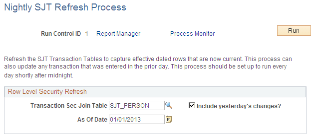

Nightly Refresh SJT
Run the Nightly Refresh SJT process nightly to refresh the transaction security join tables. The nightly refresh process:
Updates the transaction security join tables with any changes to transaction security data that bypassed the SavePostChange PeopleCode.
The system automatically updates the transaction security join tables when you make and save a change on the transaction components, either by manual entry or a mass update that triggers the component interface. If you bypass the PeopleCode, you will need to capture the changes using a refresh process.
Updates the security join table with future-dated security rows that have become current (when the current calendar date matches up with the effective date of the transaction record) because SavePostChange PeopleCode is not triggered when a future-dated row becomes current.
If you are using future-dated security rows deletes the old security row and makes the future-flagged row the current row.
Run this process nightly for every security set you are using.

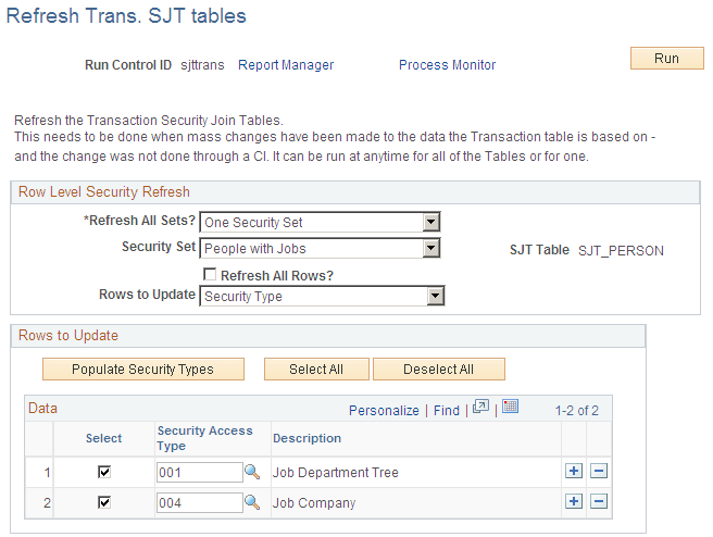

SJT Refresh
Run the SJT Refresh process to refresh the transaction security join tables.
You will need to refresh the tables using this process when you:
Enable or disable a security access type.
When you enable a security access type, you need to load the transaction security data for that type into the security join table.
You need to run it when you disable a security access type in order to clear the security join table of the transaction security data. You won't compromise your security if you don't run it but you will improve performance by removing the unnecessary rows.
Update the transaction components using a process that bypasses the component interfaces.
The Nightly Refresh SJT process also captures this data but you may want to refresh the tables immediately rather than waiting for a scheduled run.
You can run this process for all security sets at once, individually, or by a smaller grouping of data.

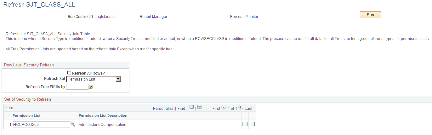

Refresh Row Security Operator
Run the Refresh SJT_CLASS_ALL process to refresh SJT_CLASS_ALL.
You will need to refresh SJT_CLASS_ALL using this process when you:
Modify a security access type.
Modifications include selecting to use future-dated security rows or changing the job data security options.
Create or modify a department security tree.
Create or modify a row security permission list on the Security by Dept Tree component.
Modifications include adding or removing data permission and refreshing the effective dates of trees.

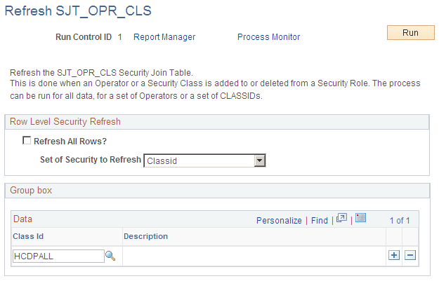

Refresh SJT_OPR_CLS
Run the Refresh SJT_OPR_CLS process to refresh SJT_OPR_CLS.
You will need to refresh SJT_OPR_CLS whenever you create or change the relationship between a user profile and a permission list with data permission. Run the process when you:
Clone a user profile that has data permission.
Add a row security permission list that has data permission to, or delete one from, a user on the User Profile - General page.
Add a role with permission lists with data permission to, or delete one from, a user.
Add a permission list with data permission to, or delete one from, a user-assigned role

Use the Nightly SJT Refresh Process page (SCRTY_SJTDLY_RC) to refresh the transaction security join tables to capture data changes that were not automatically loaded into the table.
Run shortly after midnight to capture effective-dated changes.
Navigation:
This example illustrates the fields and controls on the Nightly SJT Refresh Process page. You can find definitions for the fields and controls later on this page.
Set up this process to run every night shortly after midnight using a recurring schedule and leaving the As Of Date field empty. By running the process shortly after midnight, you capture the formerly future-dated rows that have just become effective.
Field or Control |
Description |
Transaction Sec Join Table |
Select the transaction security join table to update. |
Include yesterday's changes? |
Select to include the previous day's changes. The program searches the system for any changes to the transaction records on the previous day and updates the transaction security join tables with those changes. This ensures that any changes that were made to the data outside of components or component interfaces are captured. If you do not select this check box, the process will only update the transaction security join tables with the changes made on the as of date. Note: It is recommended that you select this option every time you run this process to guarantee that you are updating the transaction security join tables with the latest information. Only deselect the check box if you are experiencing performance issues and you are certain that the records are not being updated outside of the regular user interface or component interfaces. |
As Of Date |
Leave the as of date blank when you schedule this run control ID to run on a recurring basis. The system will use the current, system date each time it runs. |
Use the Refresh Trans. SJT tables page (SCRTY_SJT_RC) to refresh some or all of the data in the transaction-based security join tables to capture data changes that were not automatically loaded into the table.
Navigation:
This example illustrates the fields and controls on the Refresh Trans. SJT tables page. You can find definitions for the fields and controls later on this page.
Field or Control |
Description |
Refresh All Sets? |
Select All Security Sets to refresh all security sets. Select One Security Set to refresh one security set. |
Security Set and SJT Table |
If you are refreshing one security set, select the set. The system displays the transaction security join table associated with the security set. |
Refresh All Rows? |
Select to refresh every row in the security join table. Deselect to refresh select rows in the security join table. The system displays the Rows to Update grid. |
Rows to Update |
Select the rows to update. The options available are the ones you selected for the security set on the Security Sets component. |
Rows to Update
The fields and buttons in the Rows to Update grid will vary depending on the rows you select to update in the Rows to Update field. Enter the rows of data you want to update.
For example, if you select Security Type in the Rows to Update field, select the security types whose transaction data you want to refresh.
Use the Refresh SJT_CLASS_ALL page (SCRTY_OPR_RC) to refresh some or all of the data in the SJT_CLASS_ALL table to capture changes to permission lists that were not automatically loaded into the table.
Navigation:
This example illustrates the fields and controls on the Refresh SJT_CLASS_ALL page. You can find definitions for the fields and controls later on this page.
Row Level Security Refresh
Field or Control |
Description |
Refresh All Rows? |
Select to refresh every row in SJT_CLASS_ALL. Deselect to refresh selected rows. The system displays the Refresh Set field. |
Refresh Set |
Select the set of rows to refresh. The system displays the Set of Security to Refresh grid. You can select to refresh:
Refresh Tree Effdts by (refresh tree effective dates by) |
Select the date as of which you are refreshing the table. The process will refresh the table with the security data that is effective as of this date. |
Set of Security to Refresh |
Select the values to refresh. For example, if you've modified a row security permission list, rather than refreshing the entire table, select Permission List in the Refresh Set field and select the permission list you modified here. If you've modified a specific tree, select Specific Tree in the Refresh Set field and select the setID's to refresh for that tree. |
Use the Refresh SJT_OPR_CLS (security operator class) page (SCRTY_OPRCLS_RC) to refresh some or all of the data in the SJT_OPR_CLS to capture the current relationship between user profiles and permission lists.
Navigation:
This example illustrates the fields and controls on the Refresh SJT_OPR_CLS page. You can find definitions for the fields and controls later on this page.
The Refresh SJT_OPR_CLS process refreshes SJT_OPR_CLS as of the system date.
Field or Control |
Description |
Refresh All Rows? |
Select to refresh every row in SJT_OPR_CLS. Deselect to refresh selected rows. The system displays the Set of Security to Refresh field. |
Select the set of rows to refresh. You can select to refresh:
