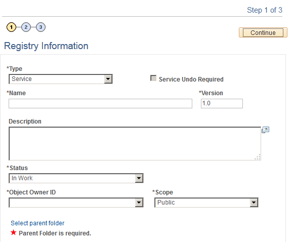

Use the Registry Information page (HMCR_WZ_STEP1) to enter information about a new interface.
Navigation:
This example illustrates the fields and controls on the Registry Information page. You can find definitions for the fields and controls later on this page.
Field or Control |
Description |
Type |
Select the interface type. Note: The pages in this component and the information you enter can vary depending on the type of interface you select here. |
Name |
Enter a meaningful name for the interface using the following guidelines:
Note: Users see the name you enter here on the registry tree so make sure that the name is clear and meaningful. |
Version |
Indicate the interface version using the format n.n. You can have multiple active versions of an interface. |
Status |
Select the status of this version of the interface:
Object owner identifier |
Select the interface provider. |
Scope |
Indicate if the interface is Public (available to everyone) or Private (available only to the provider application). |
Select parent folder |
Click this link to access the registry folder structure and select the folder within which the new interface will reside. Group interfaces by feature. |

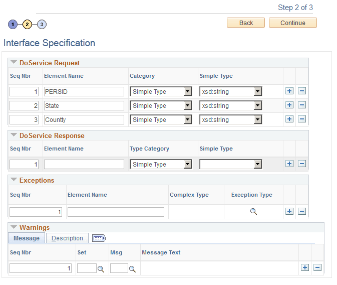

Use the Interface Specification page (HMCR_WZ_STEP2) to enter details about the new interface.
Navigation:
This example illustrates the fields and controls on the Interface Specification page. You can find definitions for the fields and controls later on this page.
Note: The system displays a different version of this page depending on what type of interface you're registering. See the Registering Services section for information on how to use this page to register service interfaces.
When you register a service, enter the follow information in the four group boxes:
DoService Request
When a service interface will be used to request information, use the fields in this grid to define the service's request parameters.
DoService Response
When a service interface will be used to respond to requests for information, use the fields in this grid to define the service's request parameters.
Exceptions
List all of the exceptions defined for the service interface. You can only select exceptions that have already be added to the registry.
Warnings
List all of the warnings and messages that could be logged during the execution of the service and that are meaningful to the consumer.

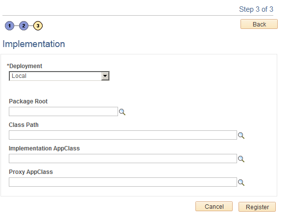

Use the Implementation page (HMCR_WZ_STEP3) to complete the registration of the new interface by implementing the interface.
Navigation:
This example illustrates the fields and controls on the Implementation page. You can find definitions for the fields and controls later on this page.
Note: The system displays a different version of this page depending on what type of interface you're registering. See the Registering Interface Views section for information on how to use this page to register interface views.
Field or Control |
Description |
Deployment and Deployment Node |
The system displays this field only when you register a Service interface. Indicate if the service is Local (resides in the same database as the consumer) or Remote (resides outside the consumer's database). If the service is remote, select the deployment node. |
Package Root |
Select the provider's root package. The root suffix depends on the interface type you are registering:
Class Path |
Select the class path to the appropriate version of your type class. |
Implementation AppClass |
Once you have implemented the class, return to the registry to select the interface's application class. Do not select a value when you initially register the interface; wait until you have implemented the interface. See Implementing Registered Interfaces. Note: If you are implementing a Service interface, populate this field only if the service is local. |
Generate Class Code |
Click to generate the PeopleCode for the implementation AppClass. You can copy and paste the code into your application class object when you implement the interface. See Implementing Registered Interfaces. Note: The system does not display this button when you register Service interfaces. |
Register |
Click to register the interface definition. When the system successfully registers the definition it will display the interface's IUD. |
