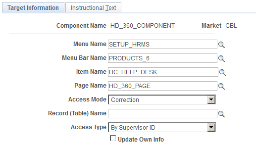

Use the Target Information page (SS_LINK_TBL) to set up the access type for the HD_360_COMPONENT.
Navigation:
This example illustrates the fields and controls on the Target Information page.
To set up the access type:
Access the Direct Reports Setup component and select the component HD_360_COMPONENT.
On the Target Information page choose the Access Type By Supervisor Id.
Save the page.
