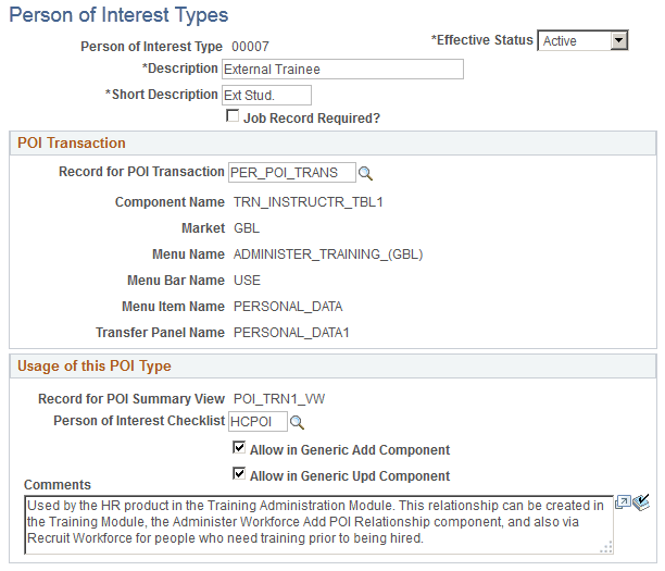

Use the Person of Interest Types page (POI_TYPE_TBL) to review the delivered POI types and modify the characteristics that govern how the system processes the information of POIs with this type.

This example illustrates the fields and controls on the Person of Interest Types page. You can find definitions for the fields and controls later on this page.

Effective Status |
Inactivate any system delivered POI types that you will not be using so that they do not appear as options on HCM transaction components. |
Job Record Required? |
Select if this POI type requires a POI job record. When you select this check box for a new POI type, the system enters default information into the POI Transaction group box that you cannot overwrite. |

Record for POI Transaction |
Select the record used for processing and holding information about people with this POI type. If you select the PER_POI_TRANS record (the generic POI transaction record used by the Person Organization Summary component), the system enters default information into the rest of the fields in the POI Transaction group box and the Record for POI Summary View field that you cannot overwrite. If you choose to use a record other than PER_POI_TRANS for POI types that do not require jobs, you will need to create a view to use in the Record for POI Summary View field in order for the data in the transaction record to show up in the Person Organizational Summary component. |
Component Name |
Select the component using the POI transaction record. When you select this POI type on the Personal Data – Organizational Relationships page and click the Add the Relationship button, the system will move you to the component you select here. |
Market, Menu Name, Menu Bar Name, and Menu Item Name |
Select the menu's market, name, bar name, and item name for the selected component. |
Transfer Panel Name |
Enter the object name of the page you want the system to open to when you click the Add the Relationship button. |

Record for POI Summary View |
Select the record from which the system draws the summary information for this POI type. When you view the organizational relationships of a person with this POI type on the Person Organizational Summary component, the system pulls the summary information from this record. If you choose to use a record other than PER_POI_TRANS, you must create a view to use here in order for the data in the transaction record to show up in the Person Organizational Summary component. Create the view in PeopleSoft Application Designer using the PER_POI_TRANS view but with different view text. |
Person of Interest Checklist |
Select a default checklist for this POI type. When you opt to assign a POI type to a person and create a POI checklist from the Personal Data - Organizational Relationships page (PERSONAL_DATA4), the system creates a record for the person on the Person Checklist page (PERSON_CHECKLIST) and adds this checklist. See Creating Checklists. |
Allow in Generic Add Component |
Select to make this POI type available when adding a record for a POI in the Add a Person component, Job Data component, and Person Organizational Summary component on the Administer Workforce menu. The system selects this check box for all new types. |
Allow in Generic Upd Component (allow in generic update component) |
Select to make this POI type available when updating a record for a POI in the Job Data component and Person Organizational Summary component on the Administer Workforce menu. |
