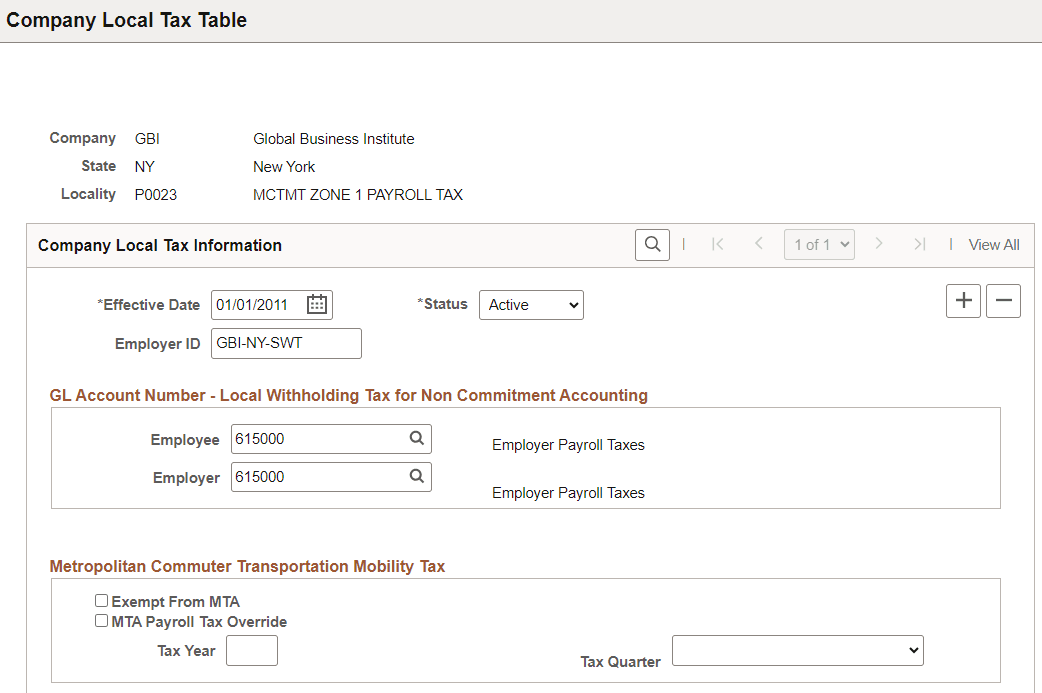

Use the Company Local Tax Table page (COMP_LOCAL_TAX_TBL) to set up an entry in the Company Local Tax Table page for each locality where the organization withholds or pays taxes.

This example illustrates the fields and controls on the Company Local Tax Table page. You can find definitions for the fields and controls later on this page.
Field or Control |
Description |
Employer ID |
This field is used for local withholding tax for this locality. It is set by default to the Employer ID for state withholding taxes on the Company State Tax table. |
GL Account Number - Local Withholding Tax for Non Commitment Accounting
These accounts are General Ledger accounts for use with local withholding tax; they are only used by the PayGL01 process. Only GL information not subject to Commitment Accounting would use these accounts.
Field or Control |
Description |
Employee and Employer |
If you have general ledger account numbers to which you post liability for local withholding tax for this locality, enter the employee and employer account numbers here. |
Metropolitan Commuter Transportation Mobility Tax
(New York) This group box appears for all state and locality entries, but it applies only to the state of New York. Fields within the group box are accessible for data entry only when State = NY and Locality = P0023 or P0047.
Note: Before entering data in this group box, you must determine the company’s MTA tax status, the maximum MTA tax rate, and the minimum quarterly threshold. Refer to the New York State Department of Taxation and Finance website for more information on the New York Metropolitan Commuter Transportation Mobility Tax (MCTMT). See http://www.tax.ny.gov/bus/mctmt/emp.htm.
Field or Control |
Description |
Exempt from MTA (exempt from Metropolitan Commuter Transportation Mobility Tax) |
Select this check box if the company is an employer type that is exempt from paying MTA tax. When this check box is selected, taxable wages will not be accumulated and tax will not be calculated, therefore the MTA Payroll Tax Override check box becomes unavailable and the MTA Payroll Tax Rate hidden. Some examples of employers that are exempt from paying the tax include: an agency or instrumentality of the United States; the United Nations; an interstate agency or public corporation created under an agreement or compact with another state or Canada; any eligible educational institution. |
MTA Payroll Tax Override |
Select this check box if the company is subject to MTA tax, but whose payroll expense for the quarter qualifies it for a lower tax rate than the maximum MTA tax rate that is delivered as the tax rate in the Local Tax Table entry for Locality NY P0023 or P0047. |
MTA Payroll Tax Rate |
Enter the tax rate that applies to the company. Enter 0.00000 if the company’s payroll expense for all covered employees for the calendar quarter falls below the minimum threshold that requires payment of the tax. |
Tax Year and Tax Quarter |
Enter the year and quarter for which the lower tax rate or exempt status applies. |
