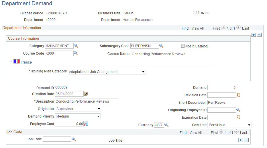

Use the Department Demand page (TRN_DEMAND_DEPT) to define the number of employees to be trained in a specific course or set of courses for a particular department during a specified budget period.
Set up training costs and budgets before setting up department demands.
Navigation:
This example illustrates the fields and controls on the Department Demand page. You can find definitions for the fields and controls later on this page.
