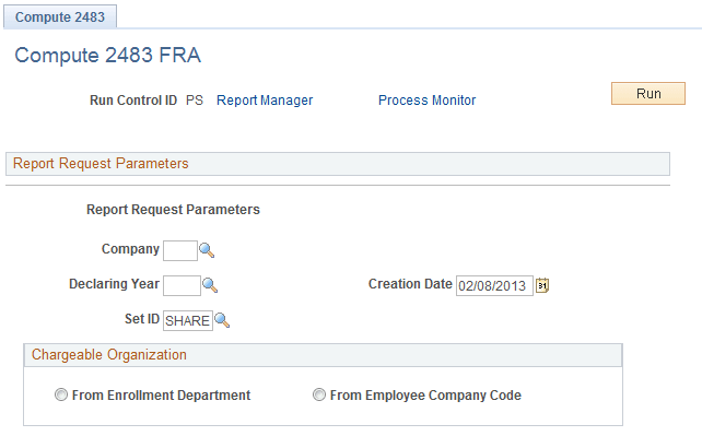

Use the Compute 2483 FRA page (RUNCTL_DEC2483) to run the Compute Training Report 2483 process.
Navigation:
This example illustrates the fields and controls on the Compute 2483 FRA page. You can find definitions for the fields and controls later on this page.
Run this process once you have entered all the training report group and indicator information.
Field or Control |
Description |
Company |
Select the company that is to run the French Training Report 2483. |
Declaring Year |
Enter the calendar year that the system is to use to determine cost information for that report. Warning! This process will override any previous results. You may lose any modifications that you made manually |
