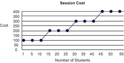

The following graph shows the relationship of cost to the number of students that are expected to take a course. Costs remain flat as you increase the number of students without having to add another session, then jump up at the point where another session is required, for example, each time the number of students reaches an increment of 15, as shown here:

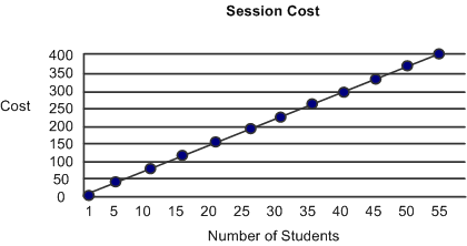

To avoid this problem, the system uses the following formula to calculate session padding and determine the cost of the training demand:
Number of students planned / Maximum number of students per course
This formula uses a progressive factor to determine the number of required sessions. The progressive factor is based on the number of students in the demand, which affects how the system determines the total session cost.
The following graph shows session costs when the progressive factor is applied. In this graphic, costs increase at a stead rate as the number of students increases:
