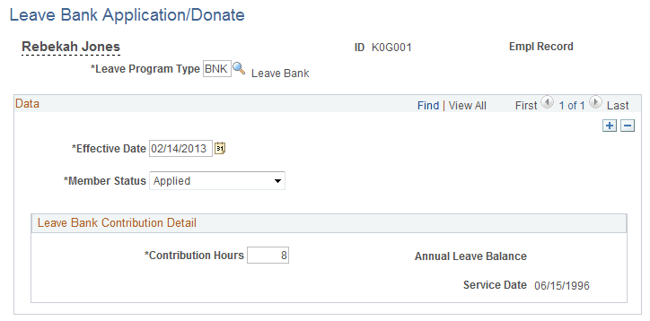

Use the Leave Bank Application/Donate page (GVT_LV_BANK_APP) to enter employee requests to contribute leave to a Leave Bank or ELTP.
Navigation:
This example illustrates the fields and controls on the Leave Bank Application/Donate page. You can find definitions for the fields and controls later on this page.
Field or Control |
Description |
Leave Program Type |
Select the leave program type to which the employee is donating. Valid values are the Leave Program Types you set up for Bank and Emergency leave programs. |
Effective Date |
The request date of the application. |
Member Status |
Select or view the member status of the leave request. Values are: Applied: The Leave Bank Board has not processed the request and no annual leave contributions have been taken from the employee's current Earnings Accrual Class balance. Approved: The leave review board has approved the donor's leave request. The system processes only Approved requests. Contribute: The system processes the hours during the next payroll cycle and updates the hours on the employee's additional pay to reduce the balance by the donation hours on the application. Only the system can update the applicant's request to Contribute; it issues an error message if you select this value. Cancelled: Indicates any other reason that the request is terminated. Denied: The Leave Bank Board has evaluated the request and denied the donor's leave request. |
Denial Reason 1 and Denial Reason 2 |
These fields appear if you select Denied as the Member Status. You must provide the applicant with at least one reason for denial. |
Contribution Hours |
Specify the number of hours the donor is contributing to the leave bank or ELTP. |
Annual Leave Balance |
Displays the number of hours of annual leave the employee has as of this request date (Effective Date). |
Service Date |
The basis for determining the length of service, on which the required contribution minimum is based. |

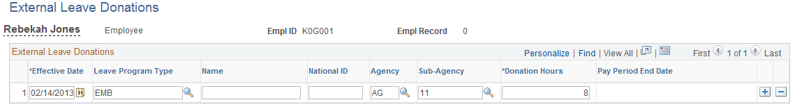

Use the External Leave Donations page (GVT_LV_DON_EXT) to enter employee requests to donate to another agency's leave transfer program.
Navigation:
This example illustrates the fields and controls on the External Leave Donations page. You can find definitions for the fields and controls later on this page.
Note: Not all page elements are visible on this page. Depending on the page arrangement, you see additional elements by scrolling either vertically or horizontally.
Record the details of donations made by an employee in your agency to another agency's leave transfer program. The system updates the donor's accrual balances when you run the Leave Bank / Transfer process.
