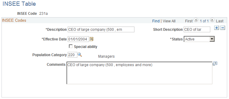

Use the INSEE Table page (INSEE_TABLE_FRA) to maintain INSEE codes for your French organization.
Navigation:
This example illustrates the fields and controls on the INSEE Table page. You can find definitions for the fields and controls later on this page.
The system displays the description that you enter for this code on pages or reports in PeopleSoft Human Resources that reference the INSEE code.
These values are set by the INSEE and classify job codes. Link INSEE codes to job codes that are used in French organizations on the Job Data - Evaluation Criteria page.
Field or Control |
Description |
Special ability |
Select if this INSEE code represents a job that requires a special ability. An worker who is assigned (through the job code) an INSEE code with this check box selected can't be listed as disabled on the French Disability report. |
Population Category |
Select the population category associated with this INSEE code. Population codes are used in the definition of contingency contracts to identify the population covered by a contract. Population codes are also used by the DUCS reporting in PeopleSoft Global Payroll for France. |

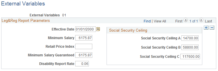

Use the External Variables page (EXT_PARM_CD_FRA) to enter information that is related to the salaries and Social Security ceilings that are established by the French government each year.
Navigation:
This example illustrates the fields and controls on the External Variables page. You can find definitions for the fields and controls later on this page.
The values that you enter act as a reference for salary and payroll processing in PeopleSoft Human Resources.
Leg&Reg Report Parameters (legislative and regulatory report parameters)
Field or Control |
Description |
Minimum Salary, Retail Price Index, and Minimum Salary Guaranteed |
Enter a minimum salary, retail price index, and guaranteed minimum salary for this external variable. The French government sets the amounts. |
Disability Report Rate |
Prior to launching the Disability report (DIS001), enter a disability report rate. The rate is set by the French government, and the current rate is 6 percent (a field value of 0,06). The disability report rate is set up in the External Variables Table. |
Social Security Ceiling
These ceiling values are determined every year by the French Social Security Administration; the values that you enter are the ceiling values that define different income brackets for French workers. They are also used as a reference for payroll calculations for French workers because many types of Social Security contributions are calculated based on the Social Security income bracket into which an worker's salary falls.
For example, if you enter the following Social Security ceilings for Social Security Ceiling A, B, and C, and the tax rates for each bracket of income are as shown:
Bracket A |
Bracket B |
Bracket C |
Above |
Ceiling |
2279 EUR |
9116 EUR |
18233 EUR |
Tax Rate |
10% |
15% |
18% |
20% |
Then an worker whose salary is 31000 EUR per month, based on this Social Security and tax rate scenario, is required to pay the following Social Security premium:
(2,279 × 10%) + (9,116 × 15%) + (18,233 × 18%) + (1,372 × 20%)

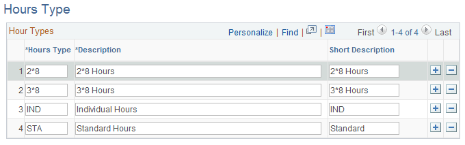

Use the Hours Type page (HOURS_TYPE_FRA) to define hours type codes that you'll use to track job hours information for French workers.
Navigation:
This example illustrates the fields and controls on the Hours Type page. You can find definitions for the fields and controls later on this page.
Field or Control |
Description |
Hours Type |
Enter the hours type code you are defining. Add rows to define as many hours type codes as needed. |
Hours Type |
Description |
3*8 |
Indicates a shift work pattern. For example, in the manufacturing or industrial sector, production can go on round the clock. The production workers are split into three groups—each group is working one after the other, eight hours a day. Every month, for example, the workers shift to another group. Shift workers who were working the 12 p.m. to 8 a.m. shift move to the 8 a.m. to 4 p.m. shift. Because this type of work schedule implies a lot of constraints in their personal life, those workers are often paid a shift bonus. |
2*8 |
Works the same way as the 3*8 option, but indicates that there are two work shifts as opposed to three. |
STA |
Indicates that the work hours follow a regular pattern using the job's standard hours as indicated on the Job Information page. |
IND |
Indicate that the worker's hours follow an individualized pattern that is different from the company's default standard hours. Indicate this amount in the Standard Hours field on the Job Information page. This field is used by the French Employee report (indicator 413 of the Employee Survey for the Trade/Services industry). |

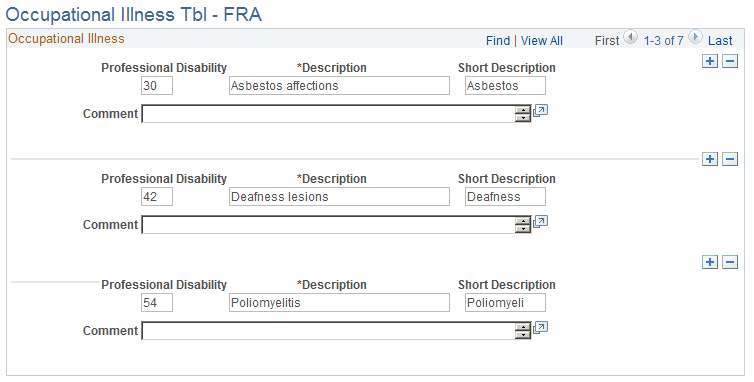

Use the Occupational Illness Tbl - FRA page (OCC_ILLNESS_FRA) to enter French occupational illness codes.
Navigation:
This example illustrates the fields and controls on the Occupational Illness Tbl - FRA page. You can find definitions for the fields and controls later on this page.
Use this page to define occupational illness categories for French workers. Use the categories when you enter information on the Disability page.
Note: The Occupational Illness Tbl - FRA table (OCC_ILLNESS_FRA) is used as a prompt table on the Prof. Dis (Professional Disease) field for the Disability page. While there is another Occupation Illness table (OCC_ILLNESS_TBL) used in the Monitor Health and Safety business process, they aren't the same page. If you're entering information about disabilities for French employees on the French Disability page, you must complete this table.
Field or Control |
Description |
Professional Disability |
Enter codes for the occupational illnesses that you want to track in your system. |
