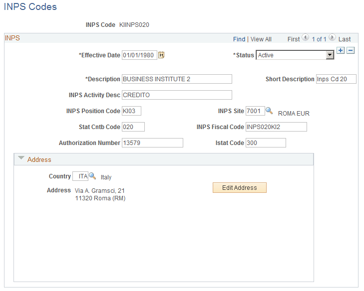

Use the INPS Codes page (INPS_TBL_ITA) to define INPS data for social security contributions and information needed for social security reporting (DM10).
Navigation:
This example illustrates the fields and controls on the INPS Codes page. You can find definitions for the fields and controls later on this page.
| Field or Control | Description |
| INPS Activity Desc (INPS activity description) | Enter the company activity description to be reported on the INPS declarations. |
| INPS Position Code | Enter the company INPS position codes. |
| INPS Site | Select the INPS site to which the company must send declarations. Set up INPS site codes on the INPS Site page. |
| Stat Contr Code (statistical contribution code) | Enter the statistical contribution code to be reported on the INPS declarations. |
| INPS Fiscal Code | Enter the company fiscal code. |
| Authorization Number | Enter the authorization codes to be reported on the INPS declarations. |
| Istat Code | Enter the Istat code to be reported on the INPS declarations. |

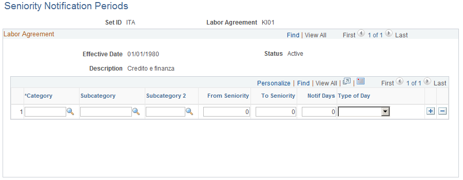

Use the Seniority Notification Periods page (SENIORIT_NOTIF_ITA) to define seniority termination notification periods for employment categories.
Navigation:
This example illustrates the fields and controls on the Seniority Notification Periods page. You can find definitions for the fields and controls later on this page.
| Category | Select the job category to which this labor agreement notification applies. |
| Subcategory | Select the job subcategory to which this labor agreement notification applies. |
| Subcategory 2 | Select the job subcategory 2 to which this labor agreement notification applies. |
| From Seniority | Enter the beginning of the seniority period to which this labor agreement notification applies. The seniority must be entered in month units. |
| To Seniority | Enter the end of the seniority period to which this labor agreement notification applies. The seniority must be entered in month units. |
| Notif Days (notification days) | Enter, in days, the seniority applicable to this period. For example, a labor agreement might require that employees employed for more than 6 months but less than 12 months have a notification period of 30 calendar days. |
| Type of Day | Indicate whether the notification uses working days or calendar days. |
