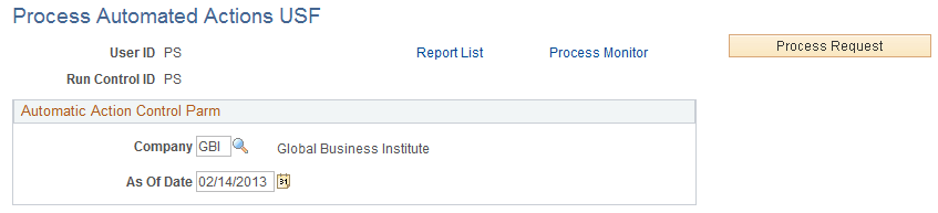

Use the Process Automated Actions USF page (RUNCTL_AUTO_ACTNS) to specify automatic action run control parameters for the probation termination and tenure conversion processes.
Navigation:
This example illustrates the fields and controls on the Process Automated Actions USF page. You can find definitions for the fields and controls later on this page.
| Field or Control | Description |
| Company | Enter the company for which you would like to identify employees and create notifications. |
| As Of Date | The as of date is set by default to the system date. The process identifies all rows with a probation date within 60 days in the future from this date. |
| Process Request | Click to run this request. PeopleSoft Process Scheduler runs the Automatic Actions process at user-defined intervals. |

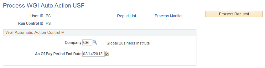

Use the Process WGI Auto Action USF page (RUN_FGHR002B) to specify automatic action run control parameters for processing WGIs.
Navigation:
This example illustrates the fields and controls on the Process WGI Auto Action USF. You can find definitions for the fields and controls later on this page.
| Company | Enter the company for which you would like to process WGIs. |
| As Of Pay Period End Date | This field is set by default to the system date, but you must change it to a valid pay period end date for the pay calendar you have created. The system processes within-grade increases for employees with a WGI due date before this date, usually the begin date for the same pay period. However, the system also processes WGIs due before this pay period-retroactive WGIs. |
