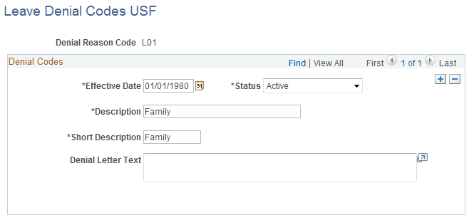

Use the Leave Denial Codes USF page (GVT_DENIAL_CD_TBL) to set up denial reasons and specify the text to be printed in denial notifications.
Navigation:
This example illustrates the fields and controls on the Leave Denial Codes USF page. You can find definitions for the fields and controls later on this page.
| Field or Control | Description |
| Denial Letter Text | Enter details of the reason for denial that you want to be printed on the Leave Denial Notifications report (FGPY031). |

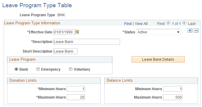

Use the Leave Program Type Table page (GVT_LV_XFR_TYP_TBL) to set up leave transfer programs, specify the program type, and indicate limits on donations and balances.
Navigation:
This example illustrates the fields and controls on the Leave Program Type Table page. You can find definitions for the fields and controls later on this page.
Leave Program Type Information
| Leave Program Type | Define your leave program codes. |
| Leave Program | Select the type of leave transfer program (Bank, Emergency, Voluntary) to associate with this Leave Program Type code. |
| Donation Limits and Balance Limits | Enter the Minimum Hours and Maximum Hours allowable for donations and balances. |
| Leave Bank Details | Click to access the Leave Bank Details page and enter the Leave Bank board members and indicate those who are labor representatives. If you select Bank in the Leave Program group box, the system adds the Leave Bank Details button to the page when you save. |
| Emergency Leave Transfer Dtl (emergency leave transfer details) | Click to access the Emergency Leave Transfer Details page and record the number of donation target hours. If the Leave Program Type is Emergency, the system adds the Emergency Leave Transfer Details button to the page when you save. |
