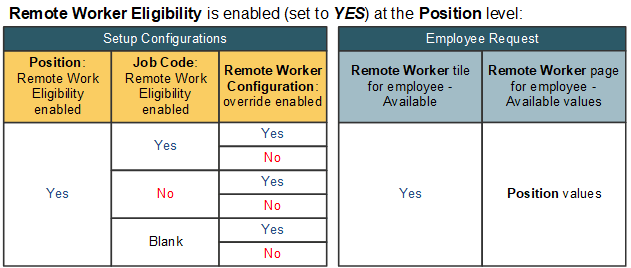

The system uses the following settings when a Position is eligible for remote work.
The position generally drives most of the eligibility for employee remote work requests. When position eligibility is set to YES, the employee will have access to the tile and request pages.
The employee will be able to submit requests using the position configured remote worker types (Fully Remote and/or Hybrid), despite the job code or override settings. If remote worker types were not defined at the position level and the eligibility was set to YES, all Remote Worker Types will be available by default to the employee when entering a request.

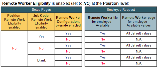

The system uses the following settings when a Position is not eligible for remote work.
When the position eligibility is set to NO, the employee will have access to the Remote Worker tile and request pages only if the Override Remote Worker Eligibility for Tile is enabled on the Remote Worker Configuration.
The Remote Worker request pages will show the default Remote Worker Type values (Fully Remote and Hybrid). Since the position overrides the job code, and the position is set to NO, the system does not consider the job code settings.
With the position set to NO (not eligible) and the override not selected, the employee does not have access to the tile, making the remote worker types not applicable (N/A), since he or she cannot access the tile to make the request.

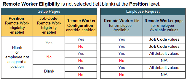

The system uses the following settings when a Position has not been configured for remote work eligibility.
When a position's remote work eligibility has not been configured and left blank or the employee is not assigned a position, the employee will have access to the tile if his or her job code is eligible OR the override setting has been enabled on the Remote Worker Configuration page. While the position typically takes precedence, with eligibility not defined, the job code is considered.
When remote work eligibility for the employee's position is not define (blank) but the job code is eligible (YES), the system will display the job code Remote Worker Type values during the request. If specific types were not identified at the job code level, all values (Fully Remote and Hybrid) will be available to the employee when entering a request.
If the job code is not eligible (NO) or its eligibility is not defined (blank), the override setting must be enabled in order for the employee to access the Remote Worker tile and request pages. In these cases, the Remote Worker Request pages will show the default Remote Worker Type values (Fully Remote and Hybrid).
With the position settings not defined (left blank), the job code set to NO (not eligible) or defined (left blank), and the override not selected, the employee does not have access to the tile, making the remote worker types not applicable (N/A), since he or she cannot access the tile to make the request.
Examples of Remote Work Type Eligibility
The following are examples of how the system determines what remote work types an employee can select based on the job code, position, and remote work configuration settings.
Scenario |
Manage/Create Position - Position Data page |
Define Job Code - Job Code Profile page |
Remote Worker Configuration page, Override Remote Worker Eligibility for Tile check box |
Employee's remote work request allows: |
1 |
Employee not assigned a position |
Eligible: YES Type: Fully Remote |
Selected |
Employee can select only Fully Remote |
2 |
Eligible: YES Type: Hybrid |
Eligible: YES Type: Fully Remote Type: Hybrid |
Selected |
Employee can select only Hybrid |
3 |
Eligible: NO |
Selected |
Employee can select either Fully Remote or Hybrid |
4 |
Eligible: NO |
Selected |
Note: In all scenarios, the Override Remote Worker Eligibility for Tile option is selected on the Remote Worker Configuration Page.
Scenario 1: The employee is assigned to a job code that allows employees to work Fully Remote but not Hybrid. The employee is not assigned to a position.
When the employee enters a request, he will be able to select only the Fully Remote option based of the job code settings.
Scenario 2: The employee is assigned to a job code that allows employees to work Fully Remote AND Hybrid. The employee is assigned to a position that allows only Hybrid remote work.
When the employee enters a request, she will be able to select only the Hybrid option, because the position takes precedence over the job code.
Scenario 3: The employee is assigned to a job code that allows employees to work Hybrid but not fully remote. The employee is assigned to a position that does not allow remote work.
When the employee enters a request, he will be able to select either Fully Remote or Hybrid, because the override option is selected on the Remote Worker Configuration page and the system uses the default remote worker types.
Scenario 4: The employee is assigned to a job code that does not allow remote work. The employee is assigned to a position that allows only hybrid remote work.
When the employee enters a request, she will be able to select only the Hybrid option based on the position settings, because the position takes precedence over the job code.

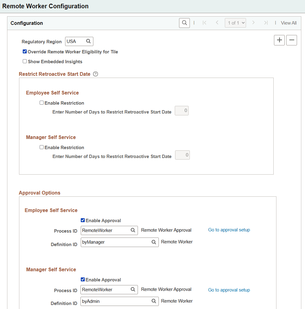

Use the Remote Worker Configuration page (HR_RW_CONFIG) to define remote work settings by regulatory region, including the eligibility override, retroactive request settings for managers and employees, approval options, and reasons for working remote.
Navigation:
This example illustrates the fields and controls on the Remote Worker Configuration page (1 of 2).
This example illustrates the fields and controls on the Remote Worker Configuration page (2 of 2).
Field or Control |
Description |
Regulatory Region |
Enter the regulatory region to which these remote worker settings apply. To add additional regulatory regions, insert a new row. |
Select this check box to override any job code or position eligibility settings. This enables the Remote Worker tile on the Employee Self Service homepage for employees that have the Fluid Remote Worker Employee role, even if their job or position is not eligible for remote work. When you deselect this option, the employee tile will only appear for those who have the role and whose:
See also the Understanding Remote Work Eligibility for Employee Requests to understand the role of the override option. |
Show Embedded Insights check box |
Select this option to display a subset of visualizations from the Remote Worker Insights dashboard on the Request Details Page for managers and administrators. Note: This feature requires PeopleTools 8.62 or higher. |
Restrict Retroactive Start Date
Use this section to determine how far back an employee or manager can enter a remote worker request for an employee.
Field or Control |
Description |
Employee Self Service - Enable Restriction check box Manager Self Service - Enable Restriction check box |
Select this option for the employee, manager, or both to prevent the employee, or manager on the employee's behalf, from entering a remote worker request with a start date beyond the number of days entered. Note: The restriction does not apply to the first remote work request. The restriction comes into effect only from second requests onward. |
Enter Number of Days to Restrict Retroactive Start Date |
This option becomes available for the Employee Self Service or Manager Self Service when you select the corresponding Enable Restriction check box. For the Employee Self Service section, enter the number of days employees can retroactively enter a remote worker request for themselves. For the Manager Self Service section, enter the number of days a manager can retroactively enter a remote worker request for an employee. For example, if the employee option is set to 5 days, and it is the 25th of the month, the employee cannot enter requests prior to the 20th of the month. However, if the manager's days are set to 20, the manager can enter a request for the employee as early as the 5th of the month, but not prior to that. Note: The restriction does not apply to the first remote work request. The restriction comes into effect only from the second request and onward. |
Approval Options
Use this section to configure approval related information for Fluid Remote Worker. You can indicate if approval is needed for the employee (Employee Self Service) or manager (Manager Self Service) to submit a remote work request.
Note: Approvals need to be enabled to use this functionality.
Field or Control |
Description |
Enable Approval |
Select to require approvals for the following:
Process ID |
The Process ID field is required if you have enabled the approval option. Associate the approval process ID that should be used when making an employee request (Employee Self Service) or making a request on behalf of the employee (Manager Self Service). When you enable the approval check box, the process ID will prepopulated with the RemoteWorker transaction, but you can override this. Note: You can associate the same process ID for the employee or manager approval options. If you enter your own approval process definition ID for creating a new row or for updating existing data, you will also need to update the Approval Process definition (Defining the Setup Process Definitions Component), the Page Composer setup (Understanding Page Composer), and Mobile Approvals options. |
Go to approval setup |
Click this link to open a new browser window and access the approval setup Register Transactions Page. You can then view or update the existing registered approval transaction setup for the process ID you entered. When no ID is entered, the system will direct you to the Register Transactions search page where you can review all transaction registries. |
Definition ID |
Enter the definition ID to be used to process the approval for either the employee or manager. |
On the submission of a transaction, the approval chain will appear on the following pages:
Remote Worker Request Page, through the Approval Chain column and link.
Status values on this page reflect the statuses as applicable for approvals.

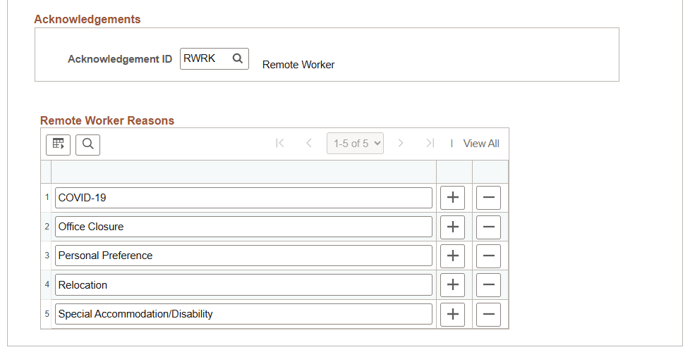

Acknowledgements
Field or Control |
Description |
Acknowledgement ID |
Enter the ID containing the message catalog entry for remote worker acknowledgement. You create acknowledgement IDs on the Acknowledgement Configuration Page. See also (Employee) Remote Worker Request - Acknowledgement Page. |
Remote Worker Reasons
Enter the valid reasons a person may be allowed to work remote.
