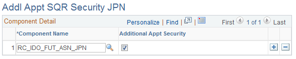

Use the Addl Appt SQR Security JPN page (AA_SECURITY_JPN) to select the reports that use additional appointment security.
Navigation:
This example illustrates the fields and controls on the Addl Appt SQR Security JPN page. You can find definitions for the fields and controls later on this page.
The following table lists the only reports that can be enabled for additional appointment security and the component name to select on the report page:
