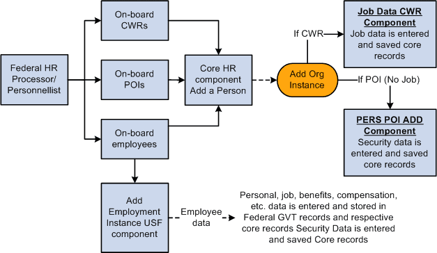

This diagram shows the process for hiring U.S. federal government employees, including hiring an existing person of interest (POI) or contingent worker (CWR) or creating additional appointments for existing federal employees:
Use the Add Employment Instance USF component to enter federal employment data for hiring an existing person of interest (POI) or contingent worker (CWR) as a federal employee. You also use this component to create additional appointments for existing federal employees.
