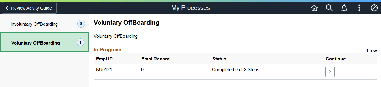

Using the My Processes Page to Access the OffBoarding Pages
Participants can also navigate to to access the OffBoarding pages.
This example illustrates the fields and controls on the My Processes page.
The My Processes (AGC_MYAG_DETAIL_FL) page functions the same as the OffBoarding - Review Activity Guide Page. View your progression or click the continue arrow (>) button to access this activity guide process instance and view or complete the activity guide.
For more detailed information, see the My Processes Page documentation.

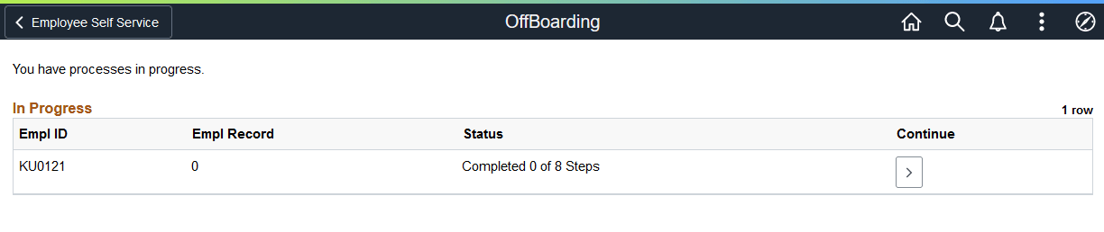

Use the OffBoarding - Review Activity Guide page (AGC_REVIEW_AG_FL) to launch the OffBoarding activity guide.
Navigation:
Access the homepage to which the custom OffBoarding activity guide tile was published, then select the tile.
This example illustrates a sample of the OffBoarding - Review Activity Guide page.
This page enables you to view your in-progress activity guides. The page will display the number of steps you have to complete and how many you have completed (answered the questions or marked the status as complete). It will not show you how many steps other participants will need to complete.
If all the steps are completed, the in-progress activity guide instance will no longer display on this page and the tile count number will be reduced by one.
Click the continue arrow (>) button to access this activity guide process instance and view or complete the activity guide.

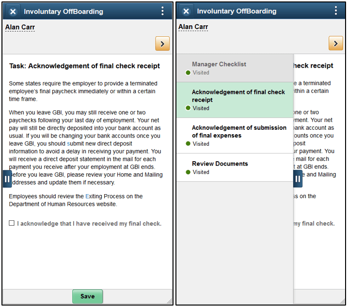

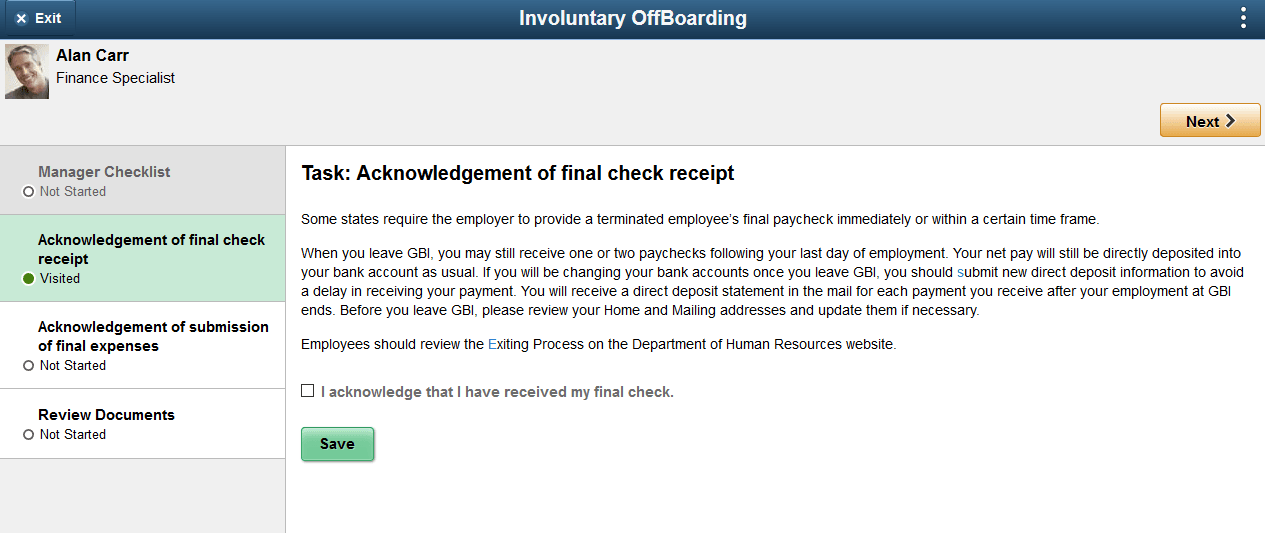

This example illustrates the layout for the Involuntary OffBoarding pages for a large form factor device.

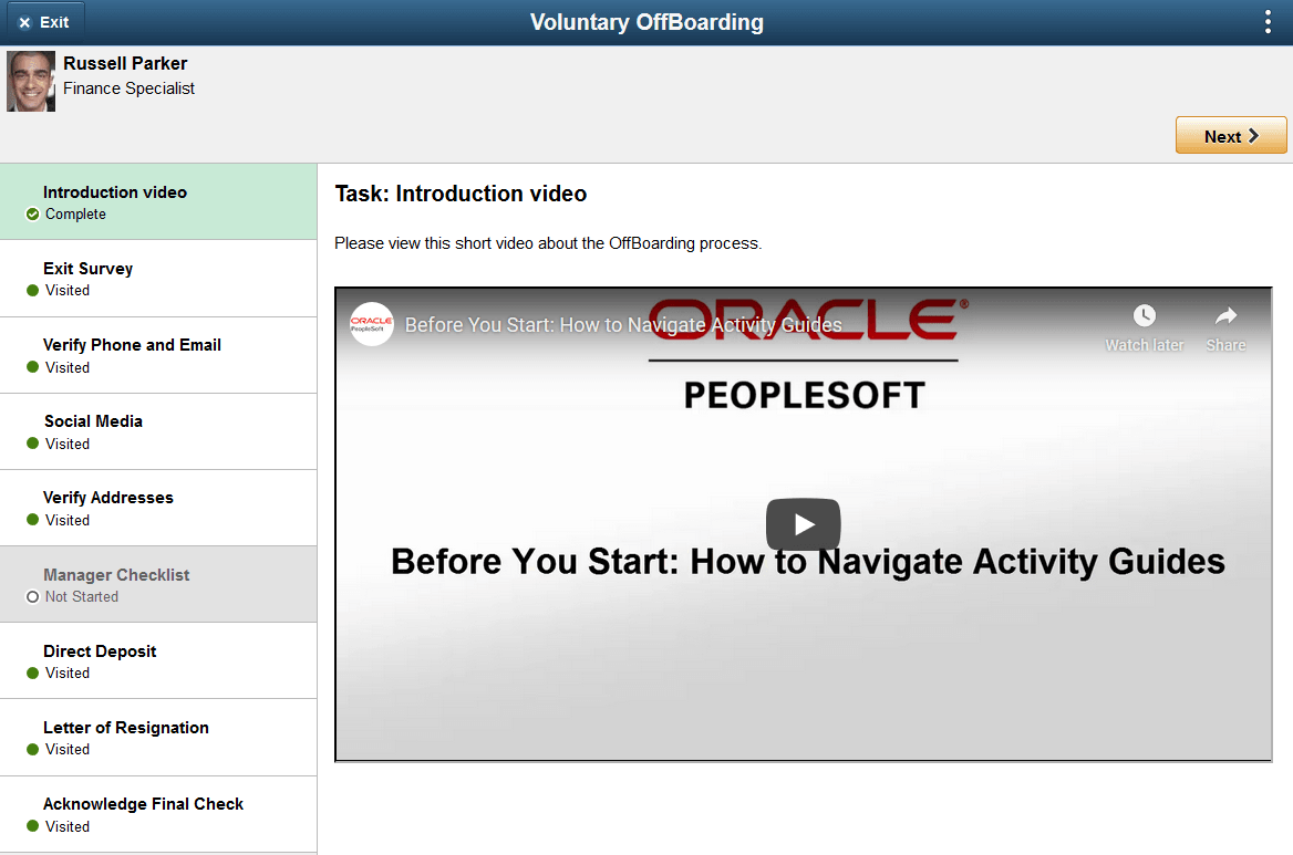

This example illustrates the layout for the Voluntary OffBoarding pages for a large form factor device.
This example illustrates the layout of the OffBoarding pages on a small form factor device. In the first image, the left panel is hidden. In the second image, the left panel is exposed.

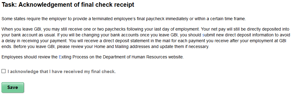

Use the Acknowledgement of final check receipt page (HCSC_ESIGN_FL) to acknowledge that you have received your final pay check.
Note: This is an employee step delivered with the Involuntary OffBoarding template.
Navigation:
From the Involuntary OffBoarding activity guide, click the Acknowledgement of final check receipt step from the activity guide navigation, or use the Next or Previous button, as needed.
This example illustrates the Acknowledgement of final check receipt page.
Select the check box to indicate that you have received your final check and click Save to mark the step a complete.

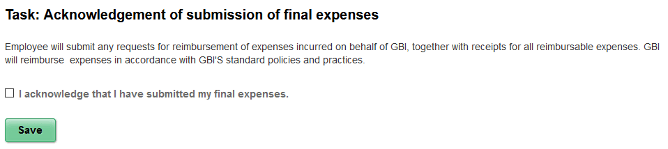

Use the Acknowledgement of submission of final expenses page (HCSC_ESIGN_FL) to acknowledge that you have submitted your final expense report.
Navigation:
From the Involuntary OffBoarding activity guide, click the Letter of Resignation step from the activity guide navigation, or use the Next or Previous button, as needed.
This example illustrates the Acknowledgement of submission of final expenses page.
Select the check box to indicate that you have submitted your final expenses and click Save to mark the step a complete.

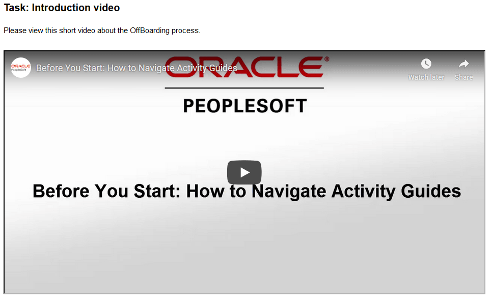

Use the Introduction video page (AGC_VIDEO_FL) to watch a video to learn how to navigate an activity guide.
Note: This is an employee step delivered with the Voluntary OffBoarding template.
Navigation:
Access the activity guide using an email or notification link, or click the OffBoarding tile, if provided.
From the Voluntary OffBoarding activity guide, click the Introduction video step from the activity guide navigation, or use the Previous button, as needed.
This example illustrates the Introduction video page.
Use this page to watch a video of how to navigate activity guides.

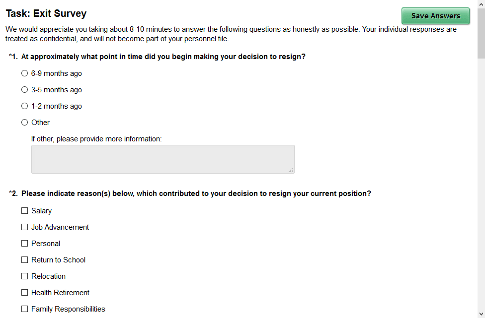

Use the Exit Survey page (EOQF_QSTNR_PRVW_FL) to complete an exit survey to help the company access your reasons for leaving the organization.
Navigation:
From the Voluntary OffBoarding activity guide, click the Exit Survey step from the activity guide navigation, or use the Next or Previous button, as needed.
This example illustrates the Exit Survey page.
Answer the survey and click the Save Answers button to mark the step a complete.
Surveys are set up using the Questionnaire framework. For more information on this, see Understanding Questionnaire Framework.

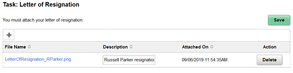

Use the Letter of Resignation page (HR_OBD_ATT_UPLD_FL) to upload your letter or resignation.
Navigation:
From the Voluntary OffBoarding activity guide, click the Letter of Resignation step from the activity guide navigation, or use the Next or Previous button, as needed.
This example illustrates the Letter of Resignation page.
Use this page to upload a resignation letter as an attachments.
Field or Control |
Description |
Add Attachment or |
Click this button to access the File Attachment page and upload files. |
Attachments and Description |
Select the link to download and view the attachment. Enter can enter a description for the attachment. |
Delete button |
Click this button to remove an attachment from this page. |
Administrators will access the uploaded files on the Employee Documents Page.

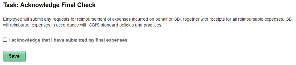

Use the Acknowledge Final Check page (HCSC_ESIGN_FL) to acknowledge that you have submitted your final expense report.
Navigation:
From the Voluntary OffBoarding activity guide, click the Acknowledge Final Check step from the activity guide navigation, or use the Next button.
This example illustrates the Acknowledge Final Check page.

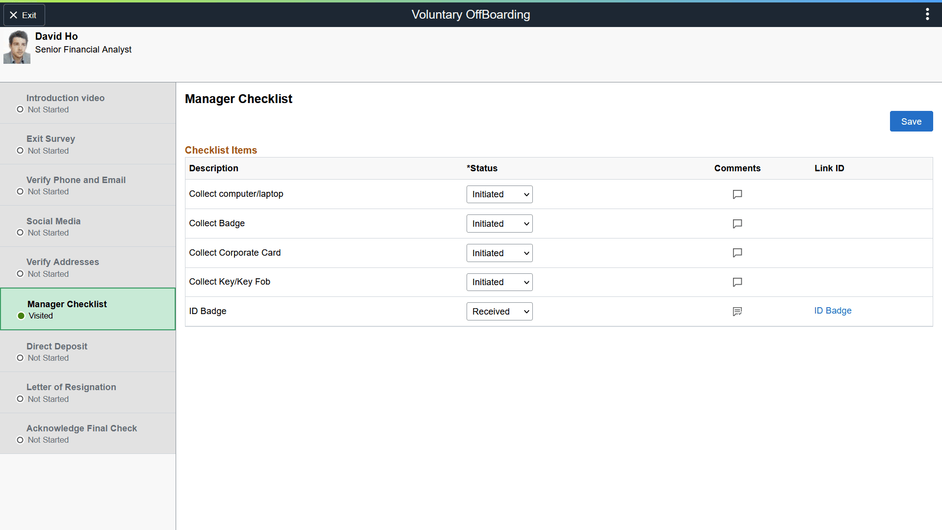

Use the Manager Checklist page (HR_AG_CHECKLIST_FL) to indicate the status of tasks that need to be completed prior to an employee’s exit from the company.
Note: This is a manager step delivered with the Involuntary OffBoarding and Voluntary OffBoarding templates, which use the (Fluid) Fluid Manager Voluntary Termination checklist (MGR_VCHKLIST_FL) step.
Navigation:
As a manager, access the homepage to which the custom OffBoarding activity guide tile was published, then select the tile.
Navigate to , select the appropriate template and activity guide.
Select the OffBoarding notification link.
This example illustrates the Fluid Manager Checklist page.
Field or Control |
Description |
Status |
Indicate the status of this checklist item. Options include:
Important! You must mark all checklist items as Completed and then save the page to set the step status to Complete. |
Comments
Select this icon to access the Checklist Item Comments Page to enter or manage additional information about an item. The callout image icon will appear blank when no comments are available and with lines in the callout when comments are present. |
Link ID |
This column displays a link to view additional information about an item, when configured as such. If no links are active, then this column is hidden. Select the link to open the corresponding page in a new browser window to review and manage badge data. Note: If the user does not have access to the component tied to the link, then the link does not appear. |
For more information on creating checklists, see Creating Checklists.

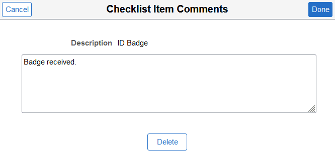

Use the Checklist Item Comments page (HR_AG_CHECKLST_SCF) to enter or manage comments or information regarding a checklist item.
Navigation:
Select the Comments icon from the (Manager Only Step) Manager Checklist Page.
This example illustrates the Comments page.
