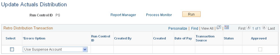

Use the Update Actuals Distribution page (RUN_HP_RETDIST) to apply retroactive distribution updates to the database.
Navigation:
This example illustrates the fields and controls on the Update Actuals Distribution page.
Field or Control |
Description |
Select |
Select the transactions (listed by the run control ID for each transaction) to process. The process will only process one selection at a time. |
Errors Option |
Select the option the process should use if there is insufficient funding for the transaction:
