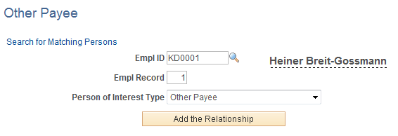

Access the component to transfer an employee to a person of interest.
This example illustrates the fields and controls on the Other Payee page.
Enter information on this page to create a POI Job associated to a new employee record. Select Other Payee as the Person of Interest Type value. The POI type is used for retirees that are not paid via Pension Administration. You can then see two jobs for this employee as you essentially have given a payee a job as a retiree.
