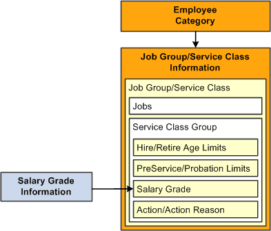

The pay grade is vital for the person’s employment terms. For GPS workers, you will map pay grades to the service class group, service class, and employee category combination, as shown in this diagram:
This diagram illustrates the association of salary grade with job group/service class on the Job Group/Service Class Information page.

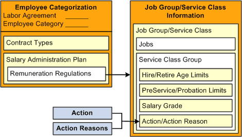

In GPS, certain actions and action reasons trigger notifications to post management and can be tied to service class groups under the job group/service classes under the remuneration regulations under the salary administration plan under the employee categories, as shown in this diagram.
This diagram illustrates the association of actions and action reasons to a job group or service class on the Job Group/Service Class Information page.
For example, you can specify actions and action reasons for the General Administration remuneration regulation, Non-Technical service class of the Civil Servant on Tenure employee category. Note that not all actions and action reasons are applicable to all employee categories. However, it is important for the Civil Servant on Recall employee category, and moving an individual from the Civil Servant on Recall category to the Civil Servant on Probation category is a significant employee data change that post management needs to be aware of, because a post management clerk will need to assign this person to another post type.
Note: An action reason not is required for a job group/service class. However, if it is not entered, any action reason associated with the corresponding Action code will trigger a post management notification.
