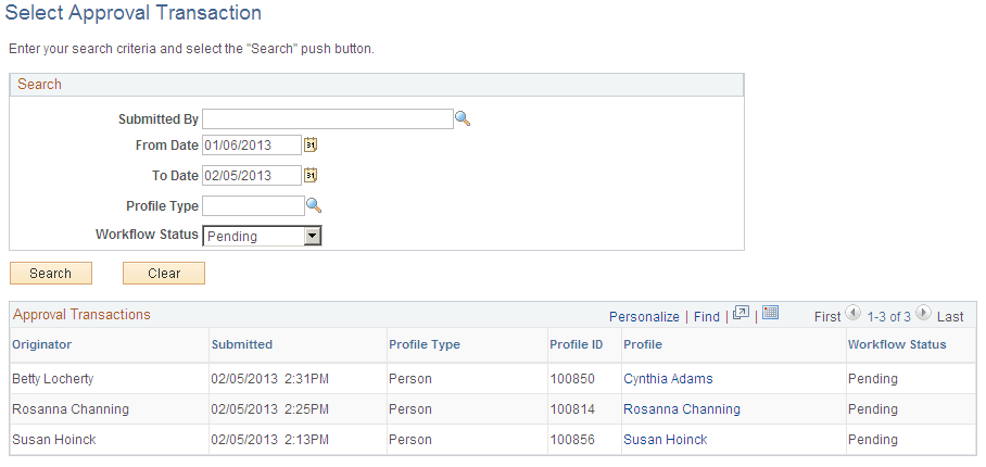

Use the Select Approval Transaction page (JPM_JP_MNG_APPRVL) to view a list of profiles waiting approval, with approved changes, or with changes that have been denied.
Navigation:
From the Workforce Administrator home page in fluid, select
This example illustrates the fields and controls on the Select Approval Transaction page. You can find definitions for the fields and controls later on this page.
Field or Control |
Description |
Originator |
Select an employee ID to search for profile changes submitted by that employee. |
From Date, To Date |
Enter period begin and end dates to search for approvals that were submitted between the selected dates. |
Profile Type |
Select a profile type to search for approvals for a specific profile type. |
Workflow Status |
Select the status of the approvals you want to view: Pending: To view profile changes that have been routed to you for approval. Approved: To view profile changes that you have previously approved. Denied: To view profile changes that you rejected. |
Search |
Click to populate the Approval Transaction scroll area with profiles that match your search criteria. |
Approval Transactions
Field or Control |
Description |
Submitted |
Displays the date that the profile changes were submitted for approval. |
Profile |
Click the profile link to view the changes to the profile that require approval. The system displays the Approve Profiles page. |

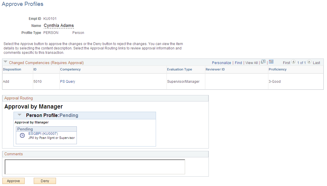

Use the Approve Profiles page (JPM_JP_PERS_APPR) to view a list of the changes to a selected person profile.
If the profile changes are pending approval, you can either approve or reject the changes.
Navigation:
Click a person profile ID on the Select Approval Transaction page.
This example illustrates the fields and controls on the Approve Profiles page. You can find definitions for the fields and controls later on this page.
Note: Profile Management does not support delegation and push back of approval transactions. All profile changes submitted together as a group for approval cannot be approved or denied at the line item level. The entire group must either be approved or denied.
Field or Control |
Description |
Disposition |
Displays one of these values to indicate the type of change: Add: Indicates a new profile item. Change: Indicates that the originator changed one or more properties for the profile item. Delete: The originator has deleted the profile item. |
<content item> |
Click a content item link to view details of the changes to the profile item. The item properties are determined by the profile type definition. |
Comments |
Enter any comments for the originator relating to this approval transaction. The comments field is available only if the profile changes require approval. For profile items that have been denied or approved, an expandable Comments section appears in the Approval Routing group box where you can view comments that may have been entered by the originator. |
Approve |
Click this button to approve the profile changes. This button appears only for profile changes with a Pending workflow status. |
Deny |
Click this button to reject the profile changes. This button appears only for profile changes with a Pending workflow status. |
Click the View Profile as Printable Page icon to display the profile in a PDF file that you can print from Adobe Acrobat. BI Publisher technology generates the printable file using the same template and layout as the Non-Person Profile batch report. The printable file displays approved items only. |
