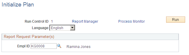

Use the Initialize Plan page (RUNCTL_NVQ005) to run the Initialize Plan process (NVQ005) for a selected employee.
This SQR process compiles the data required for the Employee Unit Plan report (NVQ006).
Navigation:
This example illustrates the fields and controls on the Initialize Plan page (NVQ005 process). You can find definitions for the fields and controls later on this page.
Use this page to run the Initialize Plan process (NVQ005) that compiles the data required to generate the Employee Unit Plan report (NVQ006).

Language |
Automatically populated based on the run control ID that you selected. Override the default language if necessary. |
