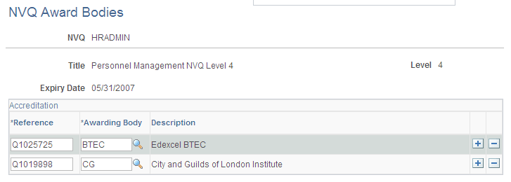

Use the NVQ Award Bodies page (NVQ_DETAILS) to specifying awarding bodies for NVQs that you have defined in the content catalog.
You must set up NVQs and the NVQ Award Body Table values in before you can use this page.
Navigation:
This example illustrates the fields and controls on the NVQ Award Bodies page. You can find definitions for the fields and controls later on this page.
Field or Control |
Description |
Level |
Displays the NVQ level that is defined for the NVQ in the content catalog. |
Expiry Date |
Displays the date on which current NVQ details will be reviewed by the awarding bodies. |
Reference and Awarding Body |
Select one or more awarding bodies. Enter the reference numbers for each awarding as provided by the NVQ. |
