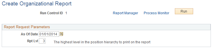

Use the Create Organizational Report page (RUNCTL_POS006) to run the Organizational report (POS006) which provides a visual representation of reporting relationships among positions by level, if any, in the organization. (SQR)
Always run this after running Build Position Structure.

This example illustrates the fields and controls on the Create Organizational Report page. You can find definitions for the fields and controls later on this page.
Field or Control |
Description |
Rpt Lvl (report level) |
Enter the highest report level you want reported on. For example, if you have 10 report levels and you only want to report on the bottom 5, enter 5 in the Rpt Lvl field. |
