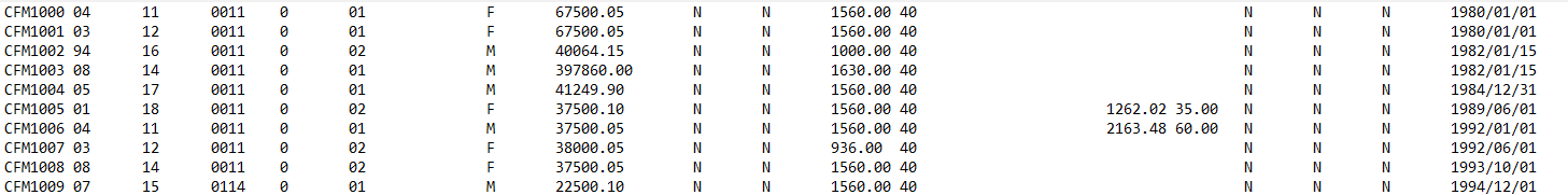

The file will create the output without column headings, similar to the following example:
Example of the EMPLOYEE.TXT file output

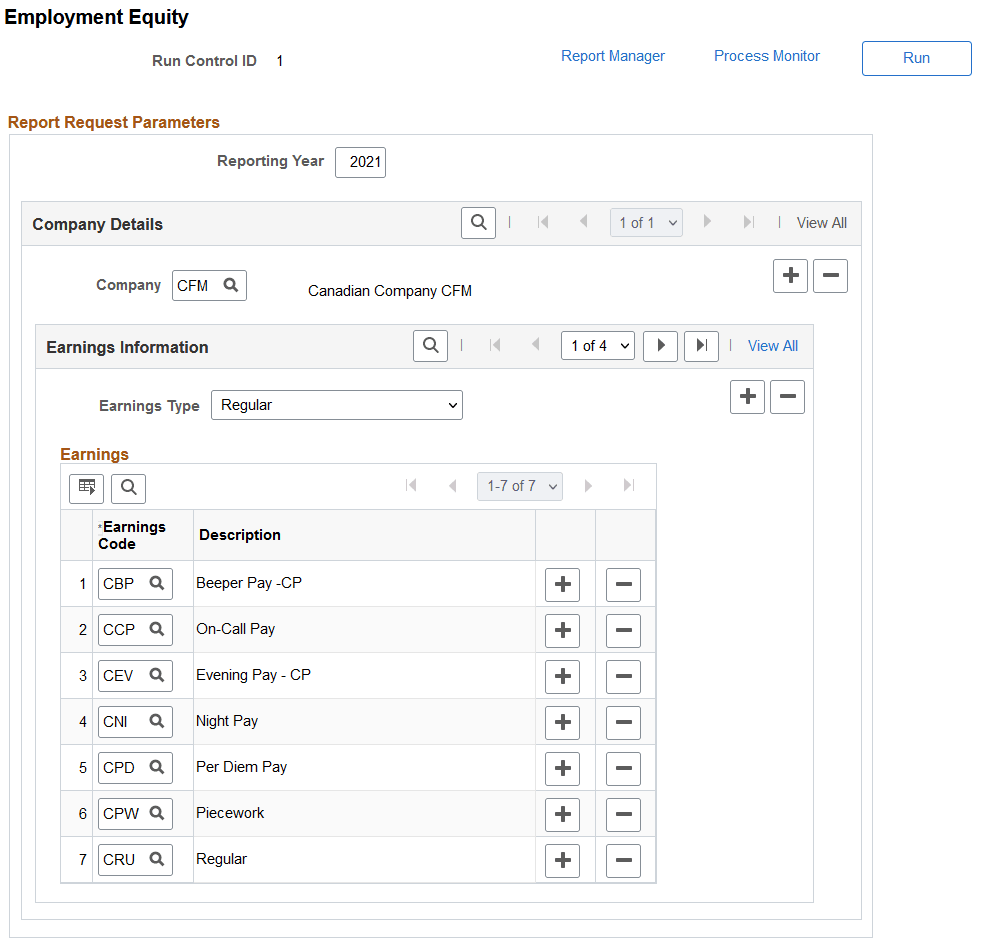

Use the Employment Equity page (RUNCTL_PER101CN) to run the Employment Equity report (PER101CN).
Note: The Employment Equity report (PER101CN) creates three data interface files (employee.txt, promo.txt and term.txt) for you to import the interface files into the federal government's WEIMS. For more information, see Understanding Employment Equity Report Files topic.
Navigation:
This example illustrates the fields and controls on the Employment Equity page.
Field or Control |
Description |
Reporting Year |
Enter the reporting year for the employment equity report. |
Company |
Enter one or more companies for which you want to report. |
Earnings Type |
Select one or more earnings to include in the file for the company. Values include:
Earnings Code and Description |
Identify earnings codes to be included in the file. |
Pay Earnings Processing
Earnings are selected for employees whose WEIMS status is 01, 02, 03, or 05. If the employee status is 04 (Other), only HR data is reported.
