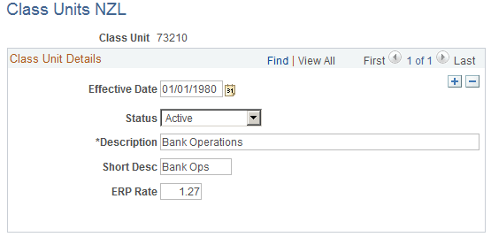

Use the Class Units NZL (classification units New Zealand) page (CLS_UNT_TBL_NZL) to create or modify the classification units used to calculate ARCI premiums.
Navigation:
This example illustrates the fields and controls on the Class Unit NZL page. You can find definitions for the fields and controls later on this page.
Field or Control |
Description |
ERP Rate (employment risk premium rate) |
Enter the rate based on the industry and the level of risk associated with that industry. The government provides these rates as set by regulation. |
