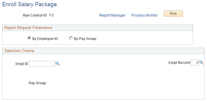

Use the De-Enroll Salary Package - Enroll Salary Package page (RUNCTL_PKG001) to run the Salary Packaging De-Enrollment PSJob process (HRAU_SPD) to de-enroll an employee or a pay group from a salary package.
Navigation:
This example illustrates the De-Enroll Salary Package - Enroll Salary Package page.

By Employee ID |
Select to de-enroll an employee in a salary package. When this option is selected, the EmplID andEmpl Record fields are activated. |
By Pay Group |
Select to de-enroll a pay group in a salary package. When this option is selected, the Pay Group field is activated. |
