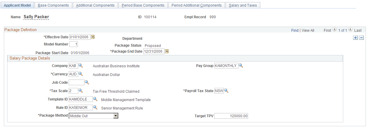

Use the Applicant Salary Package - Applicant Model page (HRS_PKG_MDL_APP) to record applicant salary packages.
Navigation:
Perform the Create Salary Package action in Talent Acquisition Manager. To perform this action, select on any of these pages:
This example illustrates the Applicant Salary Package - Applicant Model page.
Note: Most of the information on this page is identical to the information on the Employee Salary Package pages. This discussion highlights only the differences. No job record or payroll data exists for information to default from, so you need to enter data.
Package Definition
Field or Control |
Description |
Package Status |
Displays Proposed for applicants. You can't confirm or enrol packages for applicants. The applicant would need to be hired, and then have the package confirmed and enrolled through the Employee Packaging pages. |
Company |
Select the company with the vacant position or job. |
Job Code |
The job code from the job requisition, which ensures that when modelling you are using the same defaults and rules that apply to the job for employees. The job code is not saved with the applicant model. It is used only to initialize the Template andRule ID fields. |
Tax Scale andPayroll Tax State |
These values are used in the calculation of gross to net income figures and payroll tax liabilities. However, if the applicant is not an employee, enter these values or select from the list of values. |
