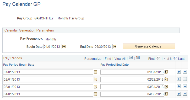

Use the Pay Calendar GP page (PKG_CALENDAR_TABLE) to create pay calendars for your salary packaged employees in specific pay groups. This information is used for package modelling so that the system can determine the budget values on the employee's package.
Note: Use only if you have both Global Payroll and Human Resources installed.

Calendar Generation Parameters
Field or Control |
Description |
Pay Frequency |
Value comes from the Pay Frequency field on the Pay Groups AUS page in Global Payroll— This group box enables you to set up default pay frequencies for the pay groups you use as part of Salary Packaging. The Package Calendar Table page also retrieves the frequency you selected. |
Generate Calendar |
Click this button to build a pay calendar. Note: The calendars that you generate on this page are used to determine the periods for budgeting purposes only. You must set up calendars before you can use the Administer Salary Packaging budgeting feature. Use the Pay Calendar GP page if you have both Global Payroll and Human Resources installed. If you have only Human Resources installed, use the Pay Calendar GP page. Both pages have the same functionality, except Global Payroll uses the pay group key and Human Resources uses the company/pay group key. |

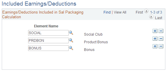

Use the Included Earnings/Deductions page (PKG_ERN_DED_INCL) to specify the non-packaged earnings and deductions elements that appear on the Package Summary component after you run the expense calculation process.
Navigation:
This example illustrates the Included Earnings/Deductions page.
Field or Control |
Description |
Element Name |
Specify the non-packaged earnings and deductions elements that you want to appear on the Package Summary page after you run the expense calculation process. You can then view the total value of any deductions, earnings, and expenses that are not included as a packaged component but have been paid out to the employee in the payroll. You can see if expenditure outside the package has occurred for the employee and quickly respond to the non-packaged payments. These types of payments may prompt you to perform a package review or some other corrective action. |

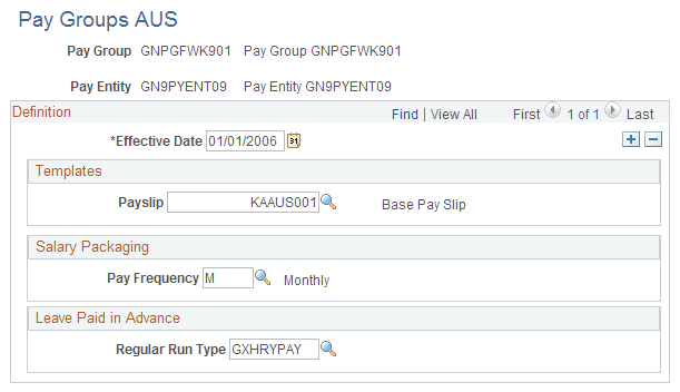

Use the Pay Groups AUS page (GPAU_PYGRP_EXT) to define additional information specific to Australian pay groups, such as the pay frequency for salary packaging.
The frequency you select enables the budgeting capabilities in the actual salary package, selecting the frequency lets the system know the type of frequency to divide the component totals
Navigation:
This example illustrates the Pay Groups AUS page.
Salary Packaging
The pay frequency is used as the default value for the pay groups that are used as part of the administer salary packaging. The defined value is also retrieved by the package calendar table to divide the component totals that budgeting uses in salary packages.
