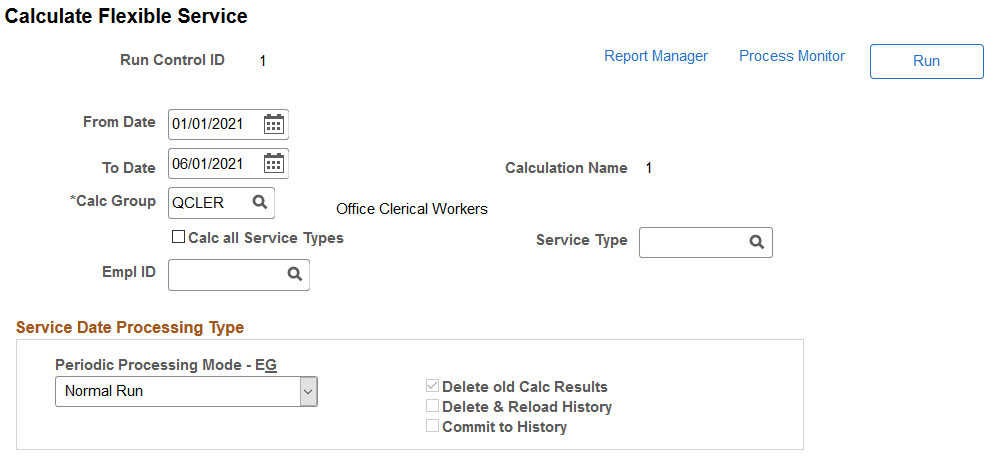

Use the Calculate Flexible Service page (RUNCTL_EGPP02) to specify time periods and calculation groups.
Navigation:
This example illustrates the fields and controls on the Calculate Flexible Service page. You can find definitions for the fields and controls later on this page.
Field or Control |
Description |
Run |
Click this button to calculate time periods and calculation groups. |
From Date andTo Date |
Enter the time period for the calculation. These dates must match a computational period of the calendar that is used by the calculation group that you are processing. The from date must match a period begin date in the calendar, and the to date must match a period end date. For example, you might want to calculate tenure for an academic year that consists of two computational periods, January 1, 2008 to June 30, 2008, and July 1, 2008 to December 31, 2008. Therefore, enter 01/01/08 as the from date and 12/31/08 as the to date. The process creates a service history for each computational period. |
Calculation Name |
This field is automatically populated from the run control ID that you entered. It is used internally by the background process. |
Calc all Service Types (calculate all service types) |
Select to accrue credits for all service types within the calculation group that is being processed. |
Service Type |
Select the service type for which you want to accrue service credits. This field is unavailable if you selected the Calc All Service Types check box. |
Service Date Processing Type
Field or Control |
Description |
Periodic Processing Mode - EG |
Select the mode that you want to use: Delete & Rebuild History: This mode deletes the worker's service history and rebuilds it. Use this to regenerate service for an individual worker (or all workers) within a calculation group. When you select this value, the system selects theDelete & Reload History check box. Warning! This mode removes all service history that is based on the calculation group or worker that you specified. Normal Run: When you select this value, the system selects theDelete old Calc Results (delete old calculation results) check box. Update to History: When you select this value, the system selects theCommit to History check box. |
