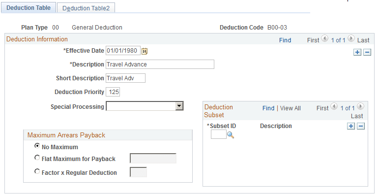

Use the Deduction Table page (DEDUCTION_TABLE1) to add deduction codes and classification information.
Navigation:
This example illustrates the fields and controls on the Deduction Table page. You can find definitions for the fields and controls later on this page.
For deduction codes for global assignments, enter a Plan Type of 00.
Warning! Enter information in these fields only: Effective Date, Description, and Short Description. Otherwise, the system assumes that the code that you define here is for payroll purposes when you enter the code on other assignment pages. You could also receive an error message if you don't fill in all of the required fields that are on the other pages for the table that is in the Payroll for North America or Payroll Interface menus, depending on the payroll system that you use.

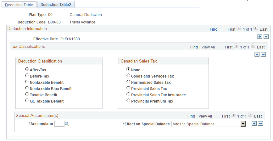

Use the Deduction Table2 page (DEDUCTION_TABLE2) to define tax treatments for assignment deductions.
Navigation:
This example illustrates the fields and controls on the Deduction Table2 page. You can find definitions for the fields and controls later on this page.
Field or Control |
Description |
Deduction Classification |
Select a deduction type. |
Canadian Sales Tax |
Select the type that is required in Canada. |

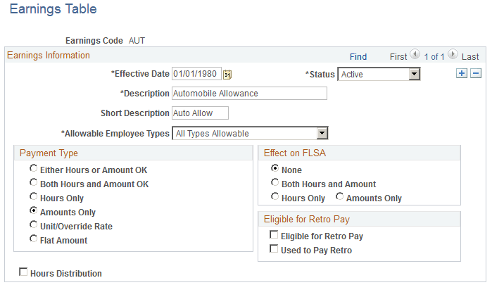

Use the Earnings Table page (EARNINGS_TABLE1) to add earnings codes for global assignments.
Navigation:
This example illustrates the fields and controls on the Earnings Table page. You can find definitions for the fields and controls later on this page.
Warning! Enter information in these fields only: Effective Date, Description, and Short Description. Otherwise, the system assumes that the code that you define here is for payroll purposes when you enter the code on other assignment pages. You could also get an error message because you don't fill in all of the required fields that are on the other pages for the table that is in the Payroll for North America or Payroll Interface menus, depending on the payroll system that you use.
