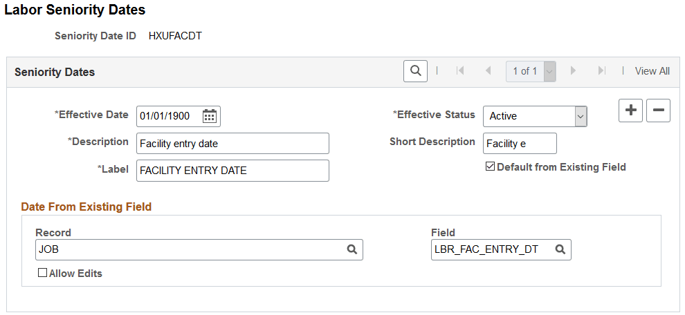

Use the Labor Seniority Dates page (HR_SNR_DATE_TBL) to set up seniority dates to track a worker's seniority for labor administration purposes.
You can base the seniority dates on existing system values or create new dates. Attach the dates you create here to labor agreements.
Navigation:
This example illustrates the Labor Seniority Dates page.
Field or Control |
Description |
Label |
Enter the label to appear next to this date field on the Job Data - Job Labor page. |
Default From Existing Field |
Select if this field's value defaults from an existing PeopleSoft system field. When you select this check box, the system makes the Record and Field fields available for entry. |
Date From Existing Field
Field or Control |
Description |
Record and Field |
Select the record and field you want to use. For example, to create a seniority date called Dept Entry that uses the Department Entry Date value from the Work Location page as a seniority date, select the JOB record and the DEPT_ENTRY_DT field. The system will display the Dept Entry seniority date on the Job Labor Workers page and automatically populate it with the date from the Department Entry Date field on the Work Location. |
Allow Edits |
Select to make the field available for entry on the Job Labor page, enabling you to override the default value. |

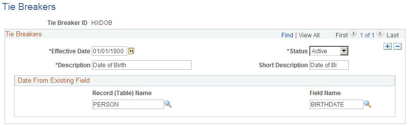

Use the Tie Breakers page (HR_TIEBREAK_TBL) to set up different types of ways to break ties between two workers who otherwise have equal seniority.
Navigation:
This example illustrates the Tie Breakers page.
Field or Control |
Description |
Record (Table) Name and Field Name |
Select the record and field value you want to use as a tie breaker. Only select records are available. |
