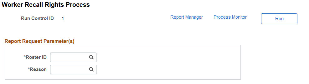

Use the Worker Recall Rights Process page (HR_RUNCTL_RGT) to update the Recall Rights component with information from the Job Data records of those candidates who have a process event status on the roster and who were processed using PeopleSoft Mass Update.

This example illustrates the Worker Recall Rights Process page.
Note: Use this process only when using PeopleSoft Mass Update to update candidates' job information. The layoff, recall, and reinstatement processes create recall rights automatically.

Roster ID |
Select the ID of the layoff or recall roster whose candidates' recall rights you want to update. The system will create a record in the Recall Rights component for those candidates who have a process event status on the roster. When an employee's recall rights have been processed for a particular Roster ID they cannot be processed a second time for the same Roster ID. |
Reason |
Select the reason for the new recall rights record. The system will insert this value in the Reason field on the Manage Recall Rights page. |

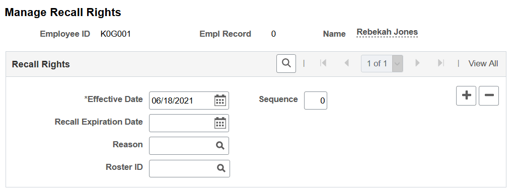

Use the Manage Recall Rights page (HR_RCL_RIGHTS) to view and maintain a worker's reemployment rights.

This example illustrates the Manage Recall Rights page.
You can manually enter and maintain recall rights for a person but the system will create and populate a row on this page for each person being processed when you run the:
Process Layoff process.
Process Recall or Process Reinst (Reinstatement) processes.
Note: The system will create rows for those who accept a recall. Employees who reject recalls may lose their Recall Rights depending on the recall rights expiration rule assigned to their labor agreement. If a person rejects a recall, update the Recall Rights manually.

This table shows the values that the system enters depending on which process you run:
Process |
Effective Date |
Recall Expiration Date: |
Reason |
Roster ID |
Run Layoff Process |
The date the layoff takes effect, as entered in the Termination Date field on the Layoff Process component. |
The system populates this date using the recall expiration rule associated with the person's labor agreement. |
LAYOFF |
The system populates this field with the ID of the layoff roster that prompted the layoff action. |
Recall or Reinstatement processes |
The date the recall or reinstatement takes effect as entered in the Rehire Date column on the Recall Roster List or Reinstatement Roster List pages. |
RECALL |
The system populates this field with the ID of the recall or reinstatement roster that prompted the recall or reinstatement action. |
Worker Recall Rights Process On the Worker Recall Rights Process page, you can select a:
LAYOFF RECALL |
The system populates this field with the ID of the roster that was selected on the Worker Recall Rights Process page. |
Field or Control |
Description |
Recall Expiration Date |
Enter the date the person's recall rights expire. The system does not include candidates whose recall rights have expired when creating recall or reinstatement rosters. |
Reason |
Select the reason the person obtained the recall right. |
Roster ID |
The system populates this with the layoff or recall roster ID. |
