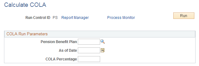

Use the Calculate COLA page (RUNCTL_PASCOLA) to change COLA payment information for retirees.
Navigation:
This example illustrates the fields and controls on the Calculate COLA page.
A COLA for a retiree typically takes the form of a percentage increase in a benefit. Pension Administration enables you to calculate and schedule the new payment amount for all employees receiving benefits from a particular plan.
COLA Run Parameters
Field or Control |
Description |
Pension Benefit Plan |
Identify the pension benefit plan granting the COLA for the increased payments. |
COLA Percentage |
The COLA percentage is the increase factor for the adjustment. This percentage is always applied to the current pension payment, a compound COLA. If you need to apply the COLA to the original amount, you must modify the COLA SQR. |
Click Run to run this request. The Process Scheduler runs the COLA Program (PASCOLA) SRQ process at user-defined intervals.
After you run the COLA Program process, you can see the COLA for any individual payee in that person's payment schedule. To do this, access the Payee Payment Schedule page.
This page contains a new row with an effective date that matches the COLA date. The Payment Reason field contains the value Result of COLA Adjustment. Both the retiree amount and any additional amounts—for example, a beneficiary amount—reflect the new, higher pension payment.
Because the beneficiary amount has been adjusted, if the retiree dies and you schedule payments to the beneficiary, the system automatically copies the adjusted amount to the beneficiary's schedule.
