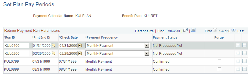

Use the Set Plan Pay Periods page (PA_RT_CALENDAR) to set up a schedule of pay periods for pension checks for a plan.
Navigation:
This example illustrates the fields and controls on the Set Plan Pay Periods page.
When you create a calendar, you assign a payment calendar name and specify the benefit plan that uses this calendar. If you do not specify a plan, all plans are selected by default.
Field or Control |
Description |
Retiree Payment Run Parameters |
Set up the retiree payment run parameters with one row per pay period. |
Run ID |
Assign a run ID to each pay period. You associate a run ID with each pay period and benefit plan, then reference that run ID when you run the Retiree Payments and Trustee Extract processes for that pay period and plan. |
Pmt End Dt (payment end date) |
The payment end date is the last day in a pay period. |
Check Date |
The check date is the date that should appear on the actual pension check. |
Payment Frequency |
The payment frequency indicates how many times per year you make payments under the plan. You can select one of these values: One Time Payment, Annual Payment, Monthly Payment, Semi-Annual Payment, Semi-Monthly Payment, Biweekly Payment, or Quarterly Payment. You typically make 12 payments for regular pension pay runs, so this is value is almost always Monthly Payment. This field is informational only. Payment processing picks up all scheduled payments, regardless of whether the scheduled payment frequency matches the frequency of the pay run ID. |
Payment Status |
The status indicates the processing stage for this pay period: Not Processed Yet, Preliminary, or Confirmed. |
Purge |
After you confirm the retiree payments for a particular pay period, a Purge check box appears for that period. If you select this check box, the system deletes the payment records for the run ID during the next payment processing. The system purges both payment records (created during the payment process) and trustee extract data (created when you run the Trustee Extract process). Purging does not affect the Trustee Extract file, which is saved to disk outside of the PeopleSoft system. |

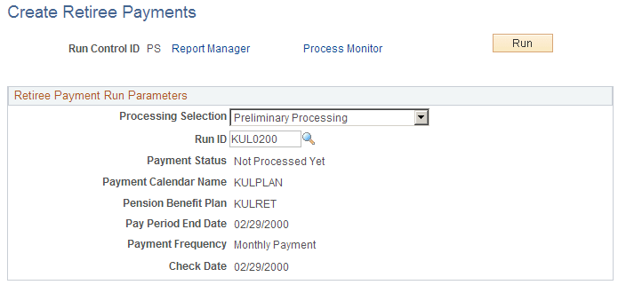

Use the Create Retiree Payments page (RUNCTL_PAPPYMNT) to process payments for pension payees.
Navigation:
This example illustrates the fields and controls on the Create Retiree Payments page.
Field or Control |
Description |
Run Control ID |
The run control ID is your link to Process Scheduler, the tool that manages your processing requests. |
Processing Selection |
Choose whether to run the processing in Preliminary Processing or Confirmation Processing mode. You cannot run confirmation processing unless you first run preliminary processing. In both modes, the Retiree Payment process creates payment data in the table PA_RT_PAY_DETL. Payments are based on scheduled payments and adjustments. Payments are identified by the run ID that you assign. If you have previously run a preliminary payment process for the same run ID, the previous payment data is deleted and the new data takes its place. |
Run ID |
The run ID identifies the pay period that you want to process. You can click the Table Lookup button to see a list of the run IDs that you created on the Retiree Set Plan Pay Periods page. |
Payment Calendar Name, Pension Benefit Plan, Pay Period End Date, Payment Frequency , and Check Date |
When you enter the run ID, the system displays the associated payment calendar name, pension benefit plan, pay period end date, payment frequency, and check date. Note: The payment frequency does not actually affect processing. For example, the monthly pay run picks up any scheduled lump sum payments. |
