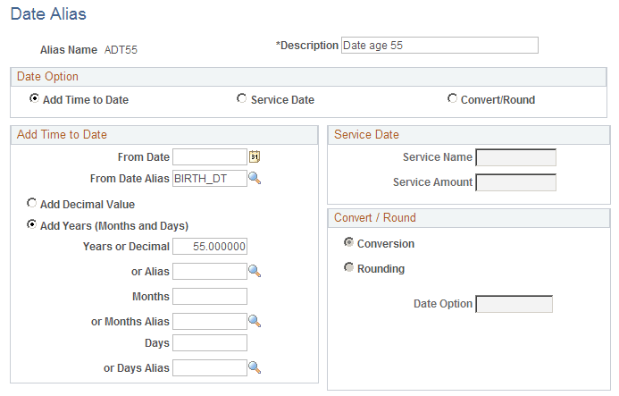

Use the Date Alias page (PA_DATE_CALC) to manipulate dates for use in pension calculations.
Navigation:
This example illustrates the fields and controls on the Date Alias page.
Date Option
Select the type of manipulation you want to perform. You can add time to a date, determine a service date, or convert or round a date. The parameters for each option appear in a group box with the same name as the option. When you select an option, the group boxes for the other options become read-only. .
Add Time to Date
Field or Control |
Description |
From |
Enter the source date as a constant or an alias. For example, to reference an employee's date of birth, enter BIRTH_DT, which is a database alias delivered with the system. |
Add Decimal Value or Add Years (Months and Days) |
Select Add Decimal Value to use decimal dates, or select Add Years (Months and Days) to use raw dates. Use the same date format as the base date. Normally you use raw dates. The only reason your base date would be a decimal date is when it is the result of another date alias that explicitly converted it to a decimal date format. |
Years or Decimal, Months, and Days |
Specify the amount of time to add.
Service
A date alias can look up the date when an employee attains a specified amount of service. For example, to set up an alias for the date of first vesting, you could look for the date when an employee will have accrued five years of vesting service.
Field or Control |
Description |
Service Name |
To set up this type of date manipulation, enter the service function result used to calculate service. |
Service Amount |
Enter the required amount of service. |
The function result provides all the information needed to calculate the date, including a projection method for future service.
The system does not necessarily determine the exact day that an employee attains the specified amount of service. Instead, the system looks at the service history, finds the period when the employee attained the specified service amount, then uses the first day of the next period. How exact this date is depends on how you set up your service requirement. Monthly service accrual methods provide more precise values than yearly service accrual methods.
Note: Service dates are not necessarily exact.

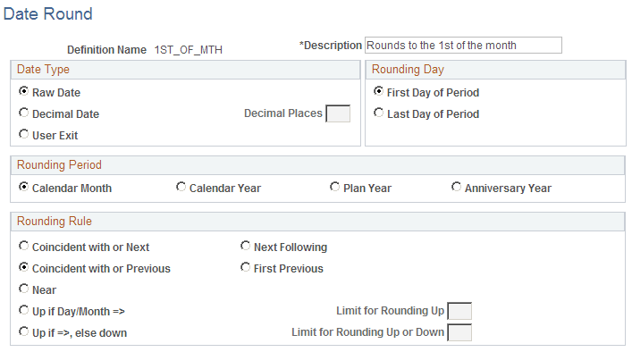

Use the Date Round page (PA_DATE_ROUND) to set up date rounding rules.
Pension plans frequently round dates. For example, if normal retirement date (NRD) is the first of the month after a participant's 65th birthday, you create an NRD alias by applying a rounding option to the date representing the birthday.
Navigation:
This example illustrates the fields and controls on the Date Round page.
Date Type
Field or Control |
Description |
Raw Date, Decimal Date, or User Exit |
Select Raw Date to use the raw date format. You can assume that you are using a raw date unless you use the date conversion option specifically to create a decimal date. Select Decimal Date to use the decimal date format, and enter the number of decimal places. Select User Exit to set up your own date rounding method. |
Rounding Day, Rounding Period, and Rounding Rule
A date rounding definition consists of three parts: the rounding date, the rounding period, and the rounding rule. These are illustrated in the following examples:
Rounding Day |
Rounding Rule |
Rounding Period |
First day of |
the previous |
month |
Last day of |
the current |
calendar year |
First day of |
the next |
plan year |
When you round to the last day of a period, you do not have to specify the rounding rule. In this case, the date is always rounded to the last day of the current period. For example, if you round to the last day of the calendar month, August 8, 2008 becomes August 31, 2008. If, however, you round to the first day of a period, you must select a rounding rule.
Basic Rounding Rules
There are five basic rounding rules:
Coincident or Next
Next
Coincident or Previous
Previous
Near
The following table illustrate how each of these options works. In all cases, the date is being rounded to the first of the month.
Rounding Rule |
Base Date |
Rounded Date |
Coincident or Next |
May 1, 2005 |
May 1, 2005 |
May 2, 2005 |
June 1, 2005 |
Next |
May 1, 2005 |
June 1, 2005 |
Coincident or Previous |
May 1, 2005 |
May 1, 2005 |
Previous |
May 1, 2005 |
April 1, 2005 |
Previous |
May 2, 2005 |
May 1, 2005 |
Near |
May 3, 2005 |
May 1, 2005 |
Rounding Rules with Thresholds
There are also two rounding rules that incorporate thresholds:
Up if Day/Month => rounds up if the day or month is greater than or equal to the threshold you set in the Limit for Rounding Up field.
Up if =>, Else Down rounds up if the day or months is greater than or equal to the threshold you set in the Limit for Rounding Up or Down field, otherwise it rounds down.
With both of these options, you specify the threshold number of days in a month (if the rounding period is months) or months in a year (if the rounding period is any type of year). Both options round up after the specified number of days or months. However, the first option leaves dates under the threshold unrounded, whereas the second option rounds down.
Note: The threshold options do not apply if you round decimal dates.
Threshold Rounding Rule |
Base Date |
Threshold |
Rounded Date |
Up if Day/Month => Threshold No. |
May 17, 2005 |
15 |
June 1, 2005 |
May 17, 2005 |
20 |
May 17, 2005 |
Up if Day/Month => … Else Down |
May 17, 2005 |
15 |
June 1, 2005 |
May 17, 2005 |
20 |
May 1, 2005 |
