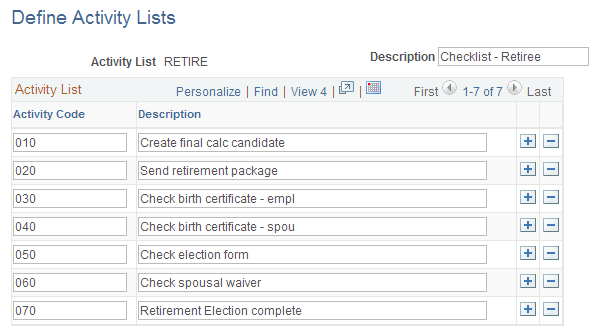

PA_RT_ACTIVITY |
Create activity lists for different types of events in the lives of plan participants. |

You can create activity lists to help you monitor these events. You can create lists for different types of event processing, such as terminations, retirements, and deaths. You can also set up lists for different types of plan participants: retirees, beneficiaries, and qualified domestic relations order (QDRO) alternate payees.
For example, you might set up a retirement activity list that includes the tasks (activities) that you must perform when a person retires. When a specific employee retires, you create a checklist for that employee by copying the standard retirement checklist.

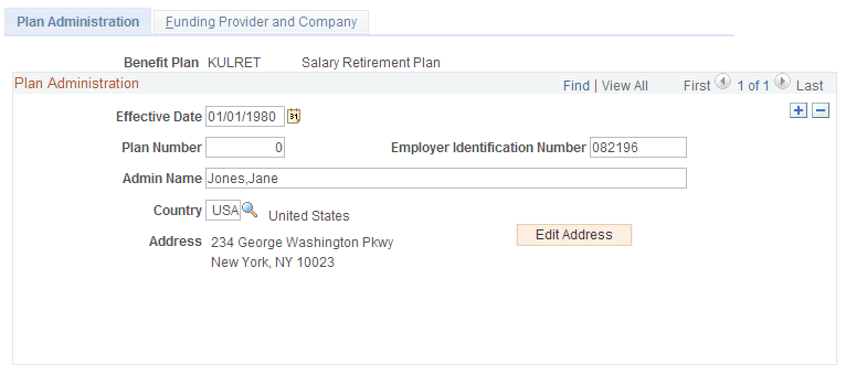

Use the Plan Administration page (PA_PLAN_ADMIN) to supply basic administrative information.
Navigation:
This example illustrates the fields and controls on the Plan Administration page.

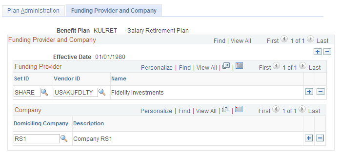

Use the Funding Provider and Company page (PA_PLAN_ADMIN_FUND) to enter funding provider and company information to identify the retiree company associated with a plan and the valid funding providers for the plan.
Navigation:
This example illustrates the fields and controls on the Funding Provider and Company page.
Field or Control |
Description |
SetID and Vendor ID |
Enter IDs for the funding provider. Only providers included on this page are valid providers when you schedule payments for a pension payee. |
Domiciling Company |
Enter the retiree company associated with the plan. This is the company—from the Company table—to which you assign payees who receive benefits from this plan. Only companies included here are valid when you create a retiree job. |
Use the Define Activity Lists page (PA_RT_ACTIVITY) to create activity lists for different types of events in the lives of plan participants.
Navigation:
This example illustrates the fields and controls on the Define Activity Lists page.
Field or Control |
Description |
Activity Code |
Enter the code of the activity to add to the list. |
