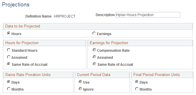

Use the Projections page (PA_PROJECTIONS) to set up projection methods.
Navigation:
This example illustrates the fields and controls on the Projections page.
Data to Be Projected
Field or Control |
Description |
Hours or Earnings |
Choose whether the projection method will project hours or earnings. If you choose Hours, also complete the information in the Hours for Projection group box. If you choose Earnings, also complete the information in the Earnings for Projection group box. |
Field or Control |
Description |
Standard Hours |
Annualizes the standard weekly hours for the employee's job as established in PeopleSoft Human Resources. |
Assumed |
Uses an annual hours amount that the pension administrator enter on the calculation page. |
Same Rate of Accrual |
Annualizes the actual period-to-date hours. |

Same Rate Proration Units
If you select Same Rate of Accrual for either hours or earnings, the system annualizes the actual earnings and hours based on the consolidation "process through" date. When you select this method, under Same Rate Proration Units, select the rate to use when annualizing.
Field or Control |
Description |
Days |
If the system prorates using days, it divides the actual earnings or hours by the number of calendar days in the partial period, then multiplies the result by the number of days in the year. This option always gives you a more precise annualization. Note: If the projection method will be applied to a monthly consolidation, you must annualize using days. |
Months |
If the system prorates using months, it divides the actual earnings or hours by the number of complete months in the partial period, then multiplies the result by the twelve. If the system annualizes using days, it divides the total hours by the number of days in the period and multiplies by the number of days in the year. Using months tends to overstate earnings because it drops any partial month, and the result is as though the employee has the same amount of earnings or hours in slightly less time. For example, if you consolidate based on a calendar year, using months to annualize period-to-date earnings of 15,000 USD as of April 15, 2001 yields:

Current Period Data
When determining the hours or earnings for the base period, use the Current Period Data group box to indicate whether to calculate data for the entire period or just for the remaining portion of the period, which is the portion for which there is no actual data.
Note: When you use the same rate of accrual method, the system always uses the annualized amount for the entire period. There is no sense in annualizing, then prorating. Therefore, this option will be made unavailable.
Field or Control |
Description |
Use |
The system calculates data for the remainder of the period and adds that to the actual period-to-date data. It looks at the partial period fraction in the base consolidation period to determine what portion of the period the existing data covers. If, for example, the partial period fraction for an annual period is .25, the actual data represents 25 percent of the period, or three months. The system then adds this actual data to 75 percent of the annual hours as determined by the compensation rate and standard hours or by the assumed amount of earnings or hours entered on the calculation page. Using this example, if the base consolidation period shows actual earnings of 10,000 USD and a partial period fraction of .25, the system multiplies the annual compensation rate by .75 (the unworked portion of the period) and adds that prorated amount to the original 10,000 USD. |
Ignore |
The system uses your chosen method to calculate data for the entire period. |
Final Period Proration Units
The final period is usually an incomplete period. The system prorates the hours or earnings based on the length of the period.
Field or Control |
Description |
Days |
As with the proration units for the Same Rate of Accrual option, the days option gives a more precise proration. |
Months |
For monthly consolidation periods, do not prorate using the months option. |
