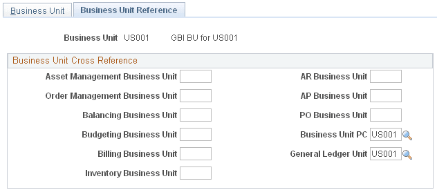

Use the Business Unit Reference page (BUS_UNIT_TBL_HR2) to enter the general ledger business unit that corresponds to each of the HR business units.
Navigation:
This example illustrates the fields and controls on the Business Unit Reference page.
Field or Control |
Description |
General Ledger Unit |
Select the general ledger business unit that corresponds to the HR business unit that you selected when you accessed the page. Available GL business units are from the BUS_UNIT_TBL_GL table. |
